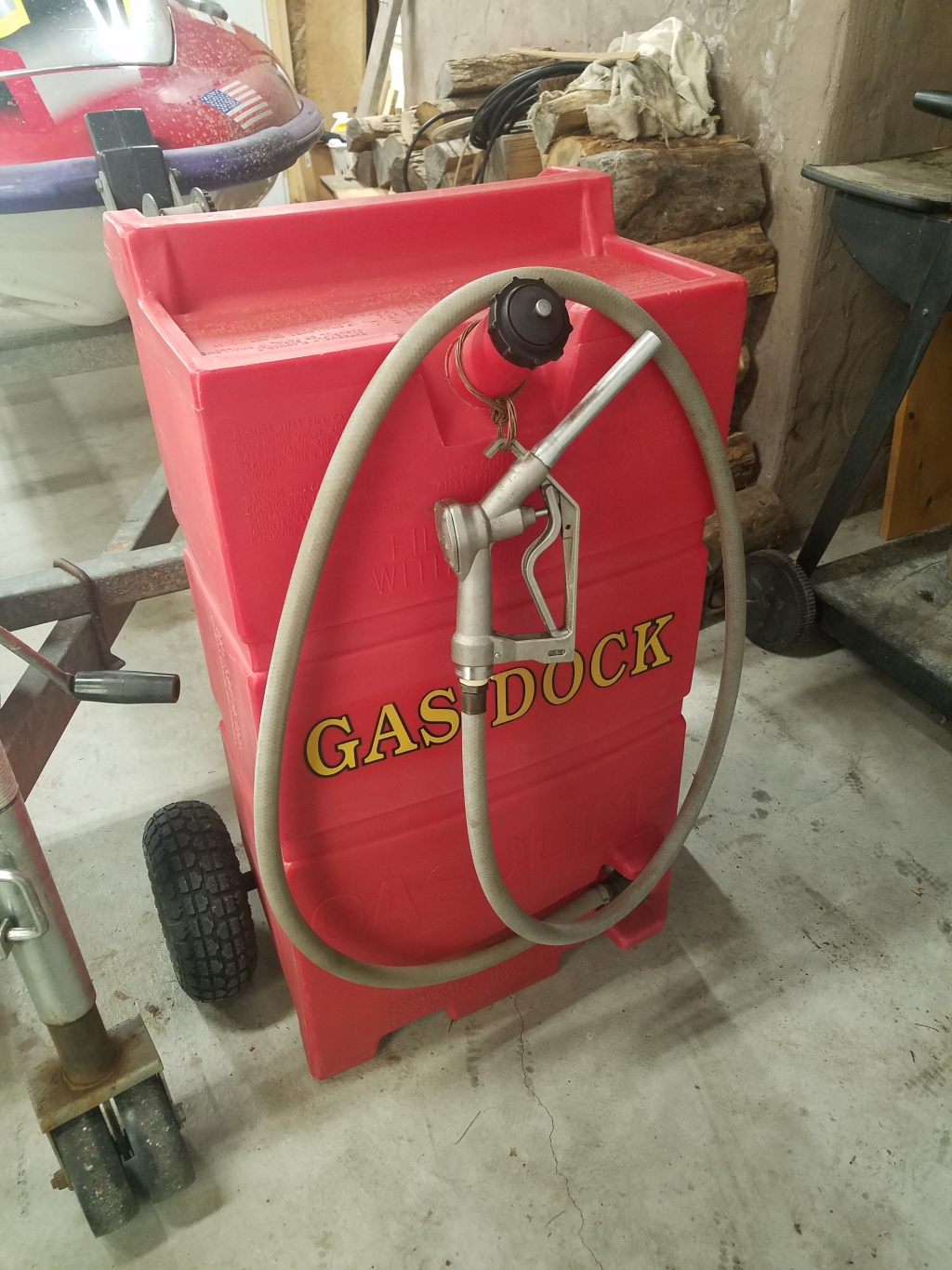

I have a 25-gallon gas caddy that's gravity-feed through a 3/4" hose. Works good but there are times when I might need to pump gas above the level of the fuel, or deliver it faster.
I'm *considering* adding an external pump, or a submersible pump, or even using my raft inflator to pressurize the tank to push fuel out.

I thought a photo might be helpful.
- caddy.jpg (1.16 MiB) Viewed 8810 times
