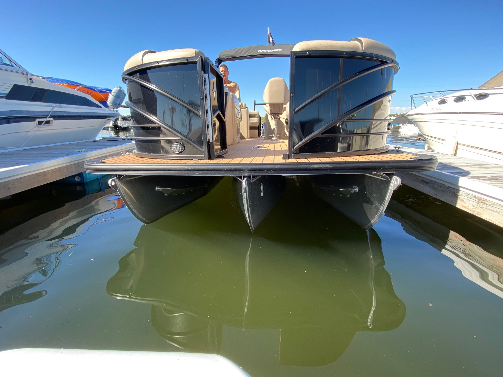

Attached is a picture of the pontoon empty, half tank of fuel (center tank) and one driver (184 pounds). Lists are hard to photograph but this one is hard to miss!

That stinks, I hate it when a MFR gives you the run around on a poorly designed product because they don't want to admit a mistake. Put more pressure on the dealer, after all they are the one who sold the boat to you. I would continue to post on as many sites as you can about the problem and name the dealer.

Have you had the boat on a trailer? I would first go to a certified scale and weigh the trailer side to side. Then put the boat on the trailer and see what the actual weight difference is.
