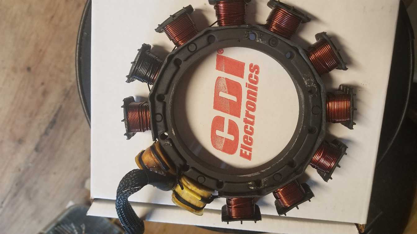

So that's the old stator. Not sure if you can see but one of the windings is severely discolored which means something happened. Fingers crossed that was it.
