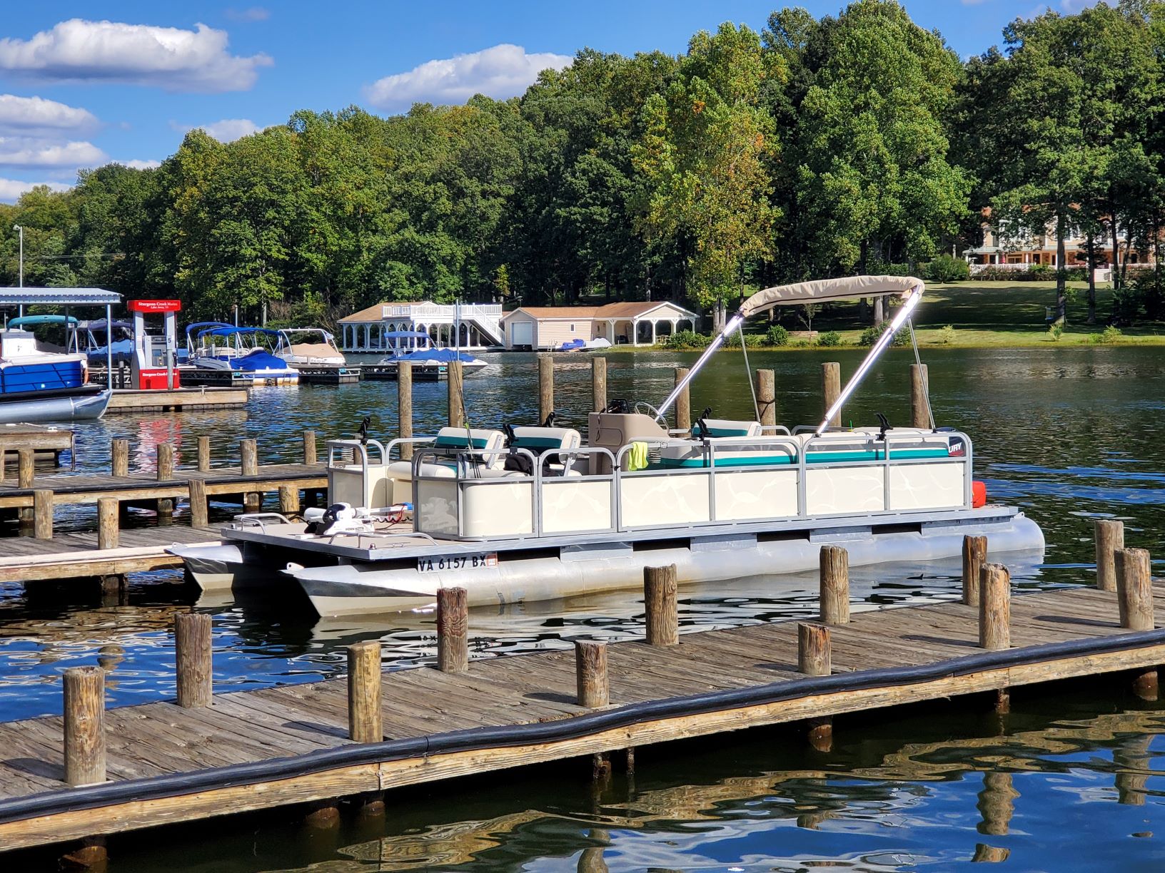

Lets see if I can show u guys a pic of the ole gal on her maiden voyage......she wasnt finished but had to take her for a spin to motivate me to finish the job.
Just lookin at this pic myself....man if it sits this low with nobody aboard imagine 4 200lb people in the stern cruisin

Not a great pic, but my boat sits pretty low even on 25" tubes. But I've also got the horsepower and the third tube so that when it is underway it sort of planes and rides a lot higher in the water.

Looking at your picture, your boat appears almost level in the water. Most boats have a decent rear "squat" stance at rest. If you have a lot of weight in the front then that can create a scenario similar to what you are describing. If your hub is not spun, I would throw some weight in the back and see if that helps with the problem.
