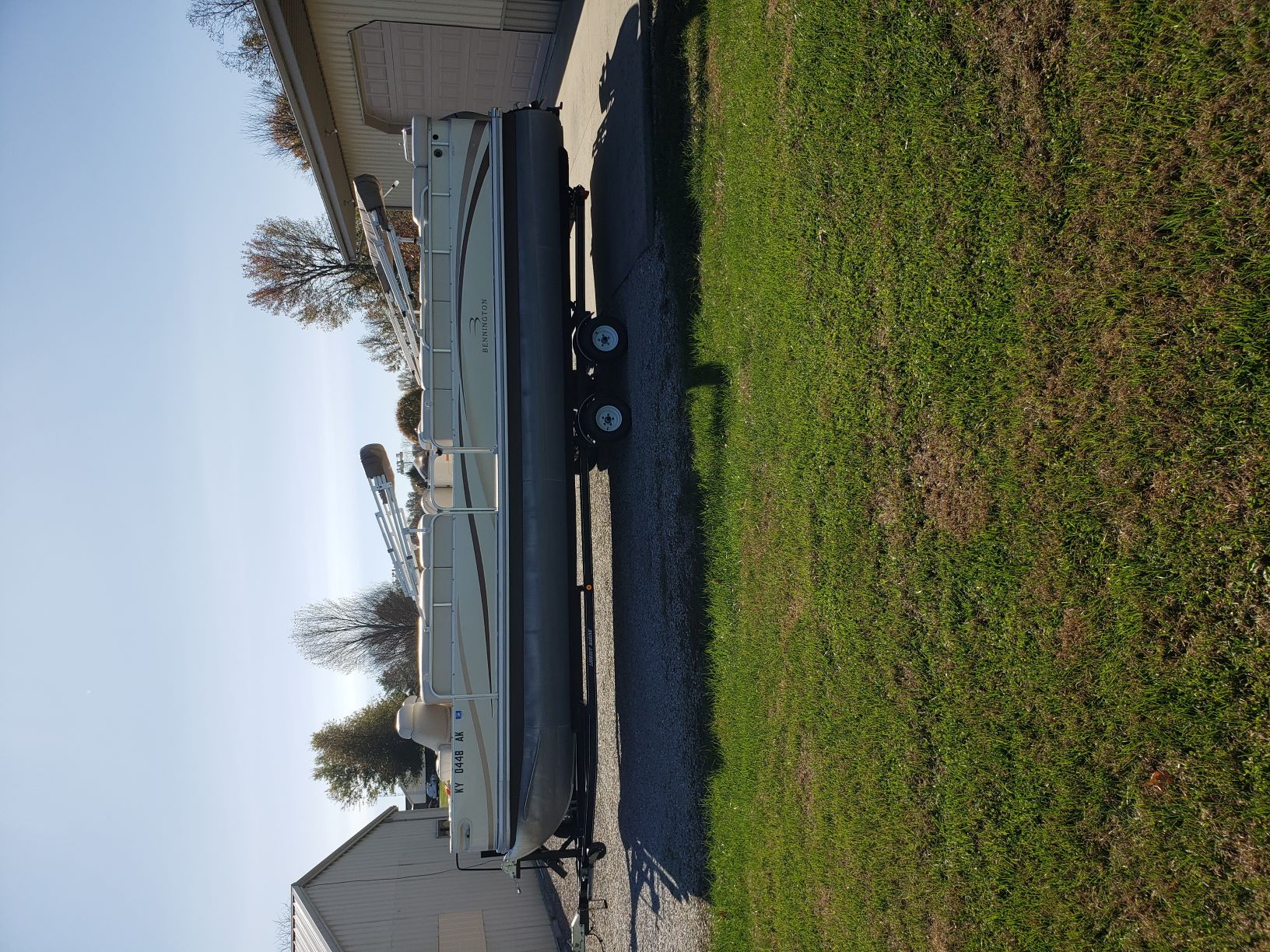

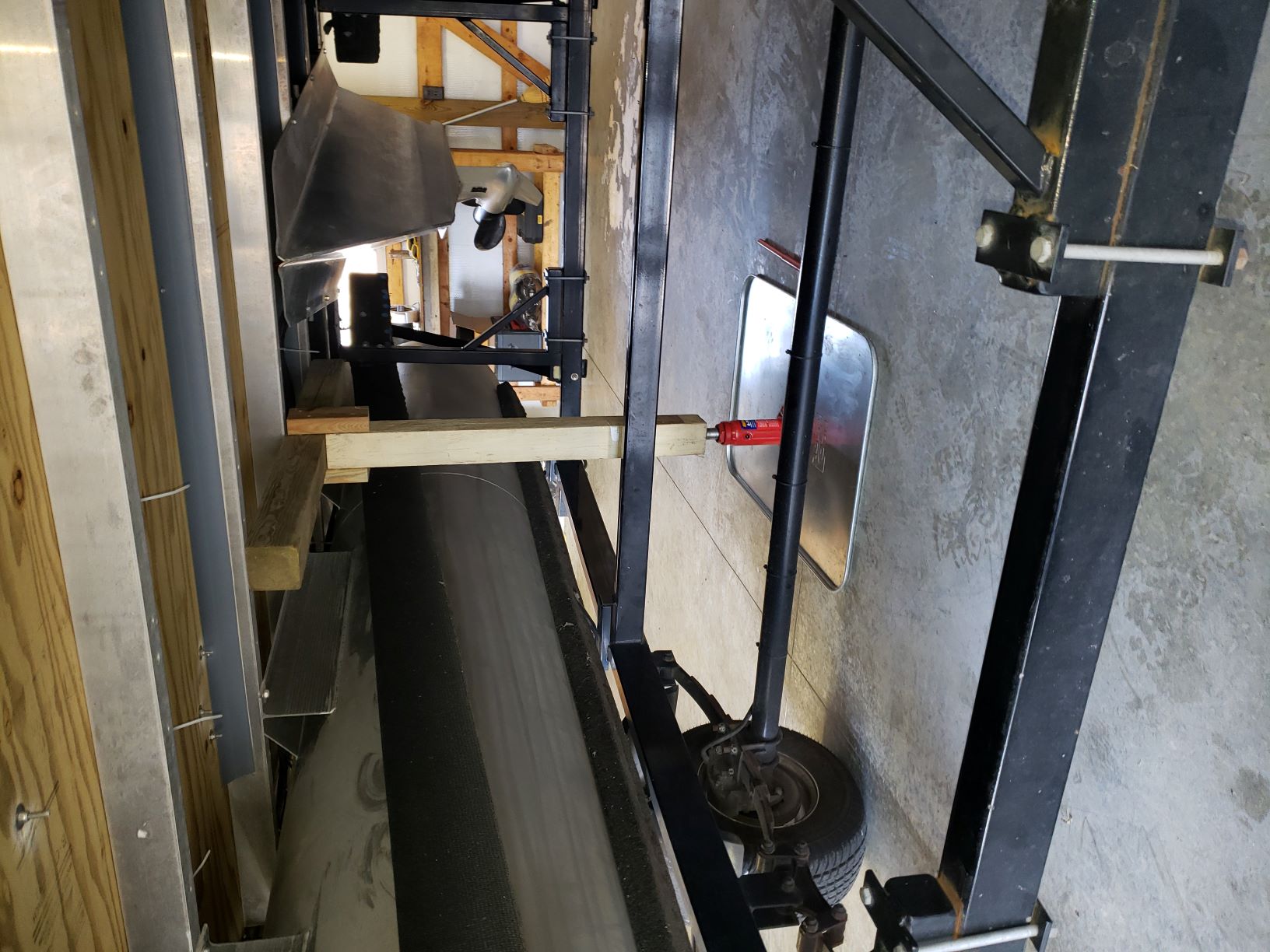

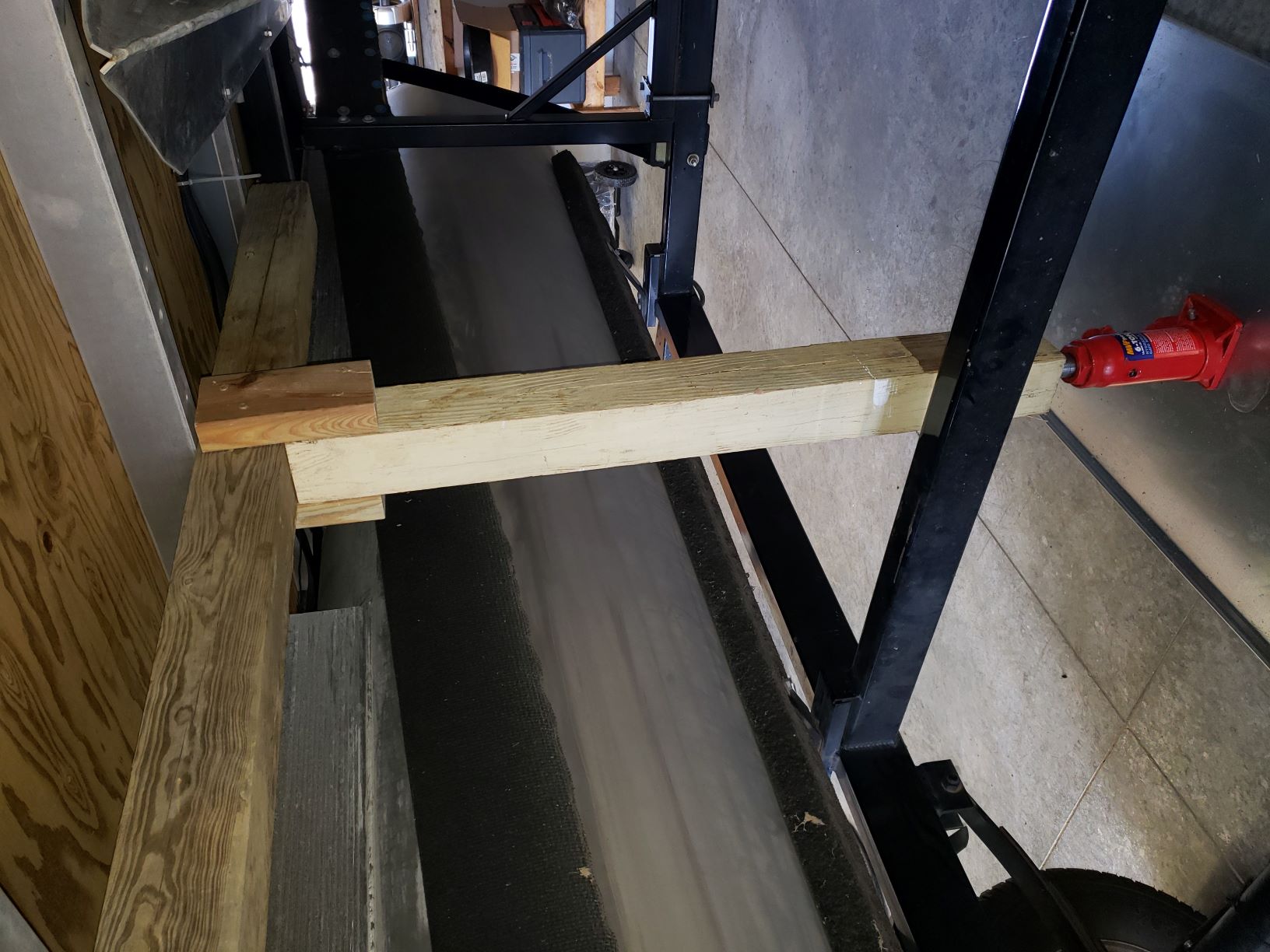

My brother and I are both recarpeting the trailer bunks on our pontoon boats. We decided to jack up the boats one side at a time and do the repairs. We came up with the idea of building a TEE from 4x4's to span three decking crossmembers. Using two of these supports, front and back, and two six ton bottle jacks, we can easily jack the boat up a couple of inches to get the boards out, one at a time. Recarpet, mount the board and remove the second one for repair. The boat cant move sideways at all, as it is still sitting on the bunks from the opposite toon. Seemed to be very stable and we were careful to make straight cuts on the posts so everything is square. This allows us to do the repair inside the shop, dead of winter...no dropping the boat in a slip somewhere to free up the trailer. Thought these pics may be of use to someone else. .. but its definitely a two man job in my opinion. We have the carpet ordered, but we've already done a test lift on this setup ahead of time and it worked great.

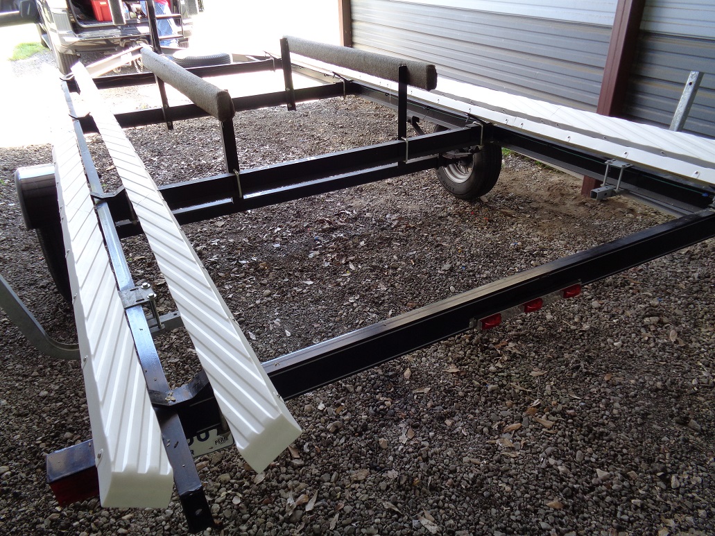

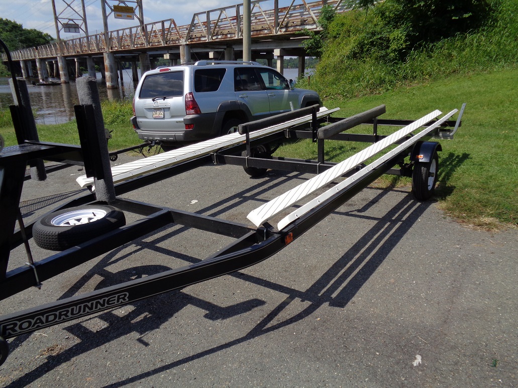

Re: Recarpet bunks by jacking the boat up
I like the way you jacked up the boat to replace the carpet on the bunks.. when we re-did our bunks a few years back it was a pain in the ass. Had to put the boat in the water, tie it up to the shore while my wife stayed on the boat sipping her favorite cocktail and reading her book... then took the boat back to the storage building where we spent several hours making the changes, then back to the lake. It worked for us, but I would have much rather done it your way.. that was good thinking. Someone mentioned with the plastic bunks they felt their boat slid back about 4 inches from the front stops. Just my opinion but don't see how that could happen unless the cinch strap wasn't rolled up tight. Mine has never moved a bit even after going to plastic bunks. But I could see where slamming on your breaks or a sharp turn to the left or right to avoid something in the road could be a problem. Also I don't worry about the boat sliding off at the launch because we never undo the cinch until we're backed down deep enough for me to start the motor, and never pull it out till it's cinched tight... Just an observation, nothing more.
