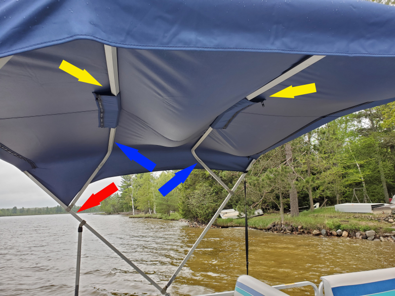

Here are a couple of observations based on my own slack problems - though not as pronounced as yours:
* Note the frame rail is in the portion of the sleeve closest to the center - providing no stretch. YELLOW ARROWS
* If you can push the frame arms so they are to the outer portion of the sleeves, or even centered it may provide some center stretch. BLUE ARROWS
* Depending on how tight the sides are, you may be able to loosen and slide the front rail arm up closer to the sleeve arm bracket - allowing the front to pull a small amount more downward. RED ARROW
Maybe this will give a little more stretch to the center of the top, but it may not be enough to totally fix your issue. As I say, that's a bit more than I've personally dealt with. I have a full boat (24') double bimini that zips together in the center.

James just sent me a replacement top. I won't get it hooked up until June something with vacation coming. I'll let you know. But it does look like it could be adjusted. I have front struts on my oem one makes it a lot tighter.

Craig your frame looks similar to mine--low arch--so I'm interested in how yours fits.
@TWB:
The tension on the top is what's pushing DOWN on the center bows and pushing them to the "inside" stops of the sleeves.
I couldn't budge them but I didn't try repositioning the pivots.
I don't think that will help but I'll try that this coming weekend when I'm there again.
My oem top had 2 sleeves for each bow, which possibly would permit a brace or even a ridge in the center but the centered sleeves on this top won't allow that option.

Hmmmm..... If the tension is already that great, you may not get any movement from moving the pivots. Usually, of course, the "droop" would be because of a lack of tension. If yours is that great, I got no clue (which is not out of the ordinary!). Sorry, man.guy48065 wrote: ↑Mon May 24, 2021 12:14 pm
