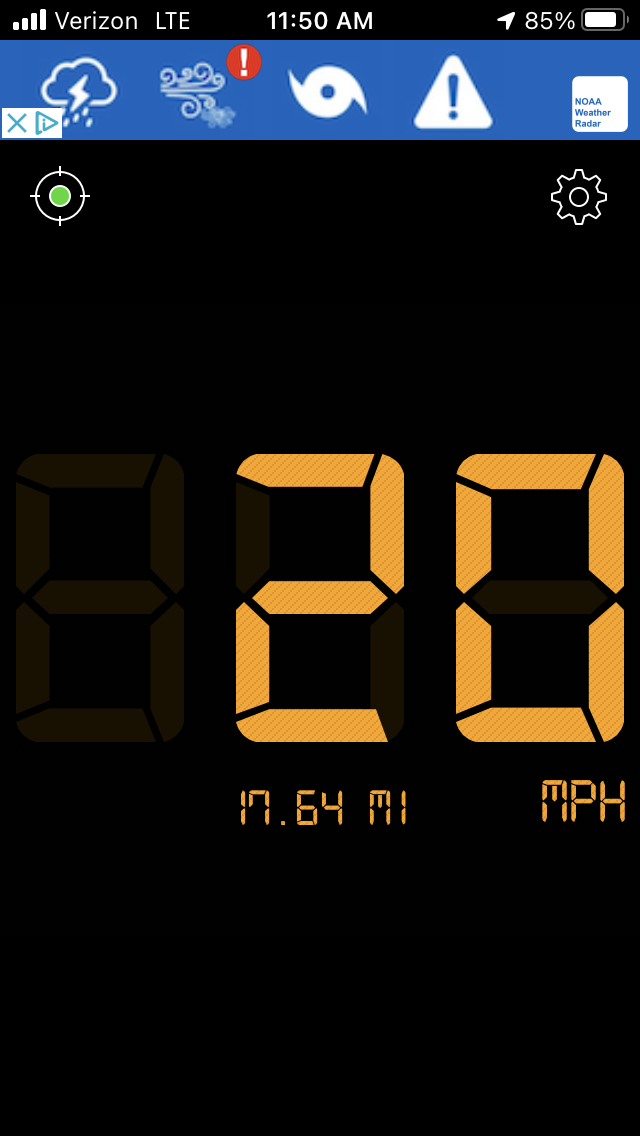

Just for comparison purposes, I have a 22' Sweetwater with a Yamaha High Thrust 50 hp, 14x11 prop @ 5800 rpm. I get exactly 20 (gps) with my wife and I on the boat in calm water.
pontoon 2019.jpg (248.29 KiB) Viewed 19132 times
