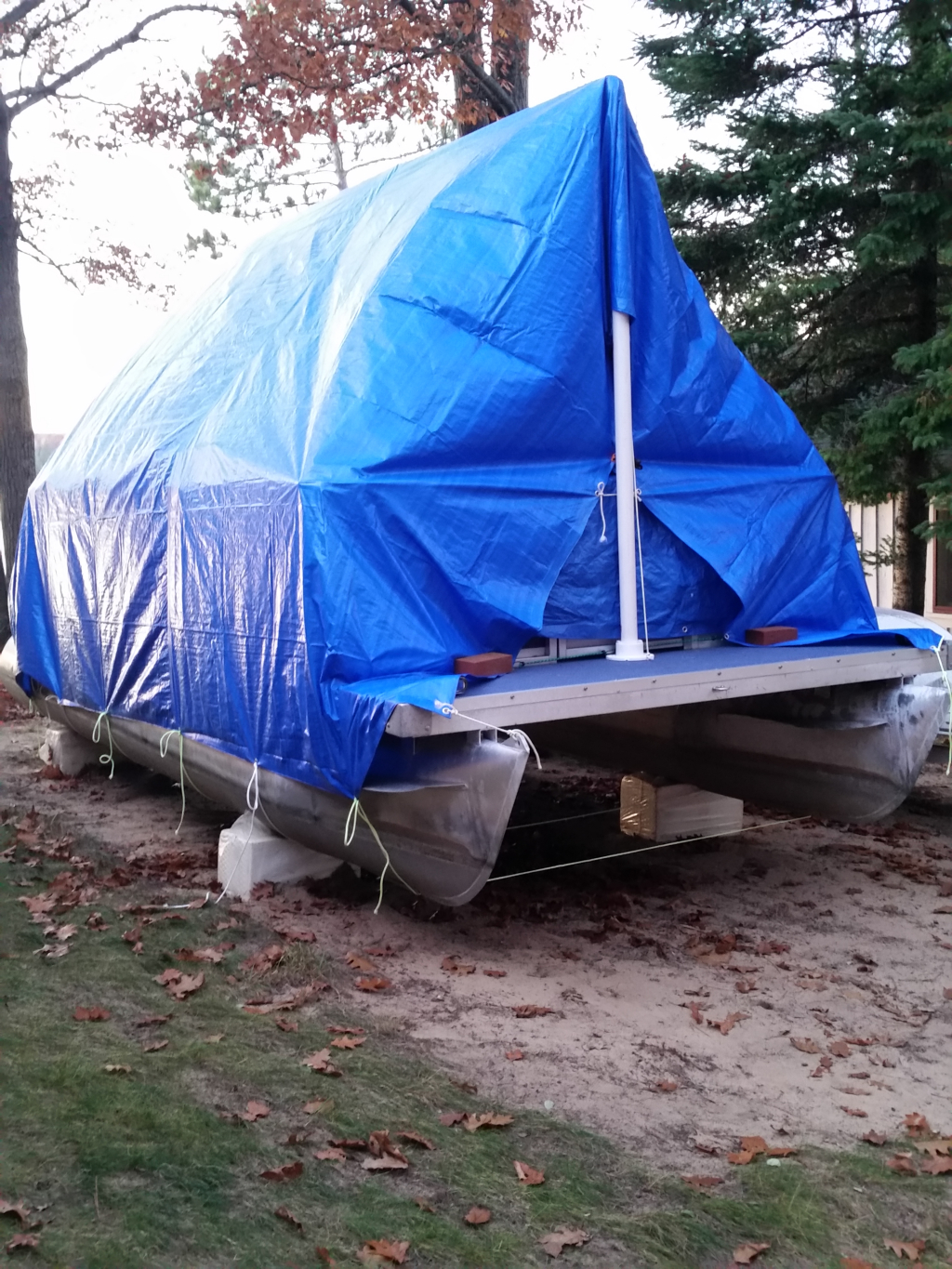

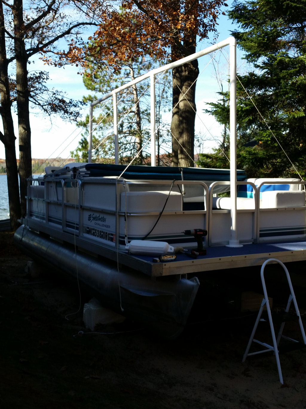

by guy48065
You don't have this issue in SC.
https://www.iboats.com/shop/navigloo-bo ... zIQAvD_BwE
I haven't found it necessary to use solid "rafters". I've been using ΒΌ" rope but I plan to replace them with 1" ratchet straps to make adjustments easier.
I store the ridge pole in my garage up in the rafters & keep the legs in the corner.
