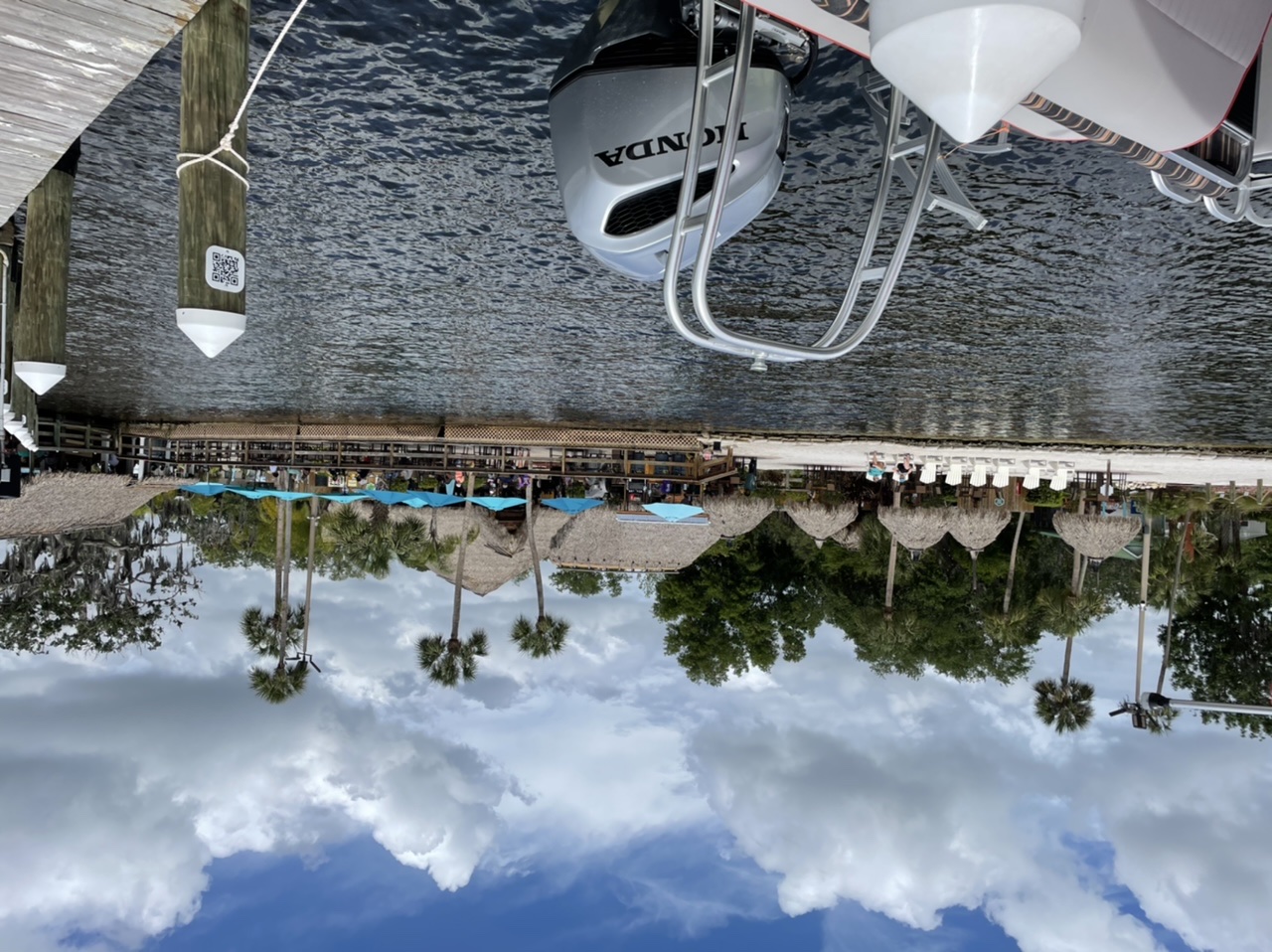

This came on our Qwest:

I've got a Turbo Swing and love it. I had my dealer remove the one that looked like the one on Rick's Qwest because it supposedly wasn't rated for tubing, and I tend to opt on the side of overkill if I have a doubt. Apparently tubing can put many more pounds of stress than skiing or wake boarding.
But I see boats all the time using a setup like Rick has for towing tubes. However, about a month ago I saw a brand new looking Tritoon in our marina with that setup and it was completely ripped out of the deck in all but one of the mounting points, so maybe it really can be a problem.
Thanks Steve!
I don’t plan on using it for anything more than possibly towing a disabled boat; but now I know to keep an eye on it! 👍
