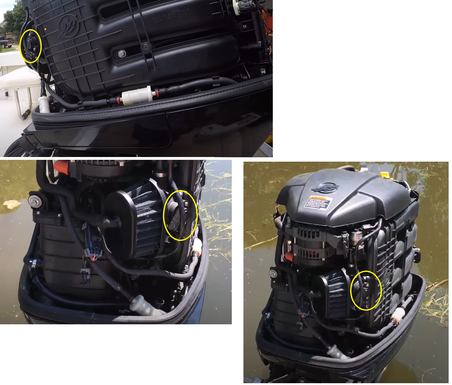

Hello,
This maybe the problem I have on my 150 HP 4-stroke Mercury. Are you able to post a pic where the TPS is located?
Thanks Reiner
Thanks Reiner

Re: Merc 4-cycle stalling, shutting off, misfiring at WOT. It was the TPS.
This is the best I could from on-line videos.
Again super easy to replace. Disconnect the sensor cables and remove two Torx screws. The old sensor will then pull off. You will see the metal throttle body shaft (where the TPS connects) will have a blade-like feature similar to a flat-tip screw driver. That feature needs to align with the plastic slot on the new TPS. Once its aligned and pressed onto the TB, simply rotate the TPS just a tad and bolt it on. Done.
Thank you, my 150 HP looks a bit different but that will give me an idea.
