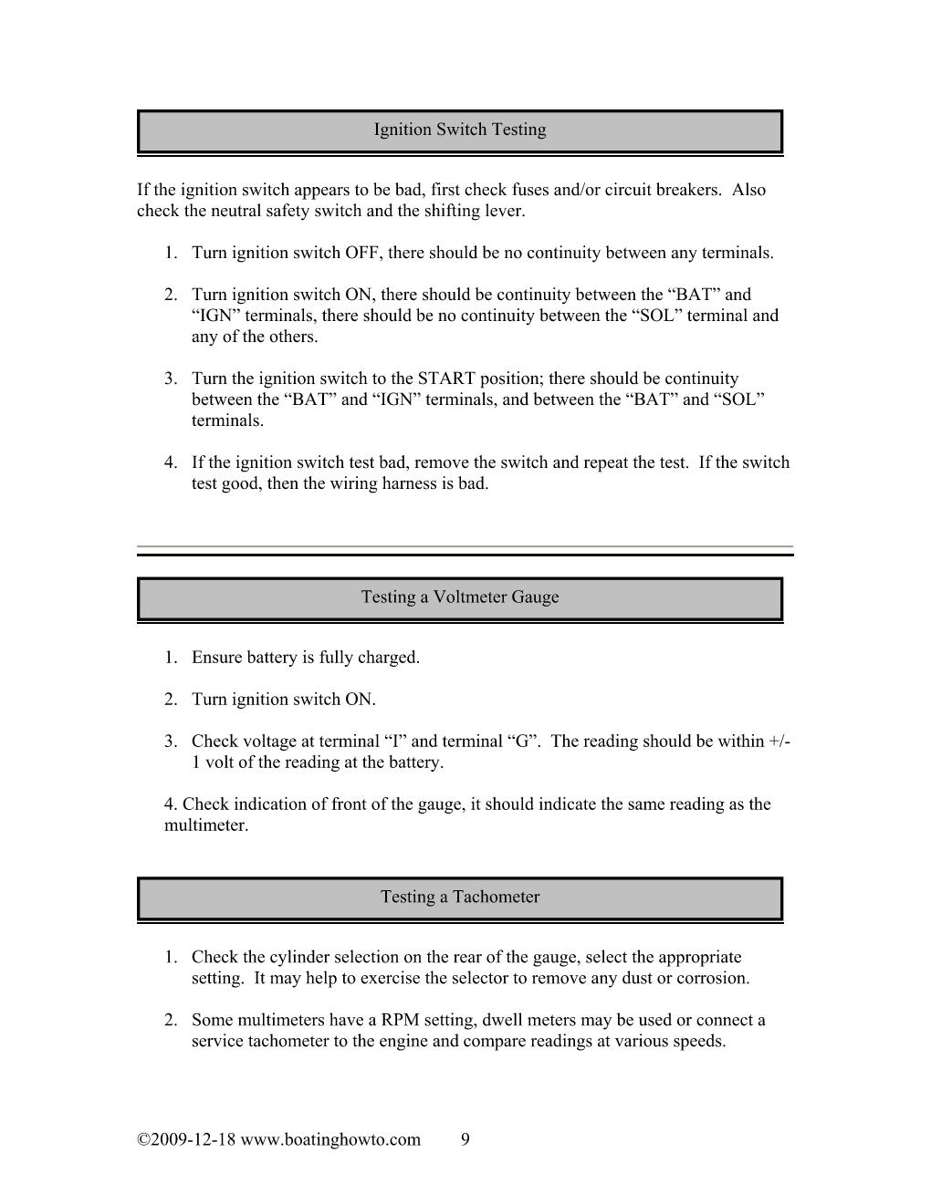

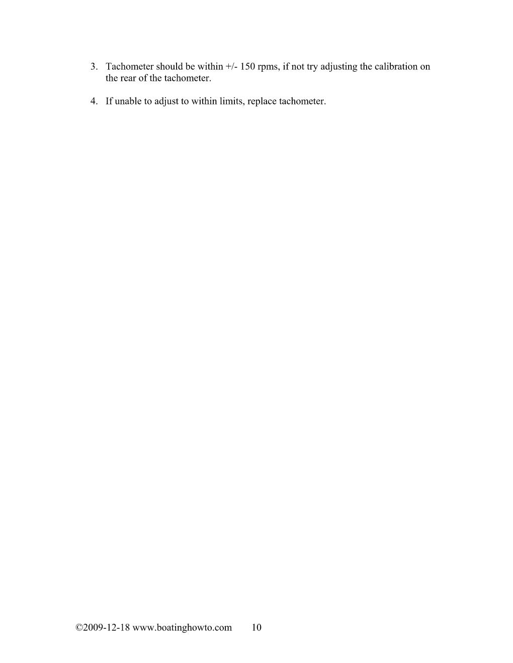

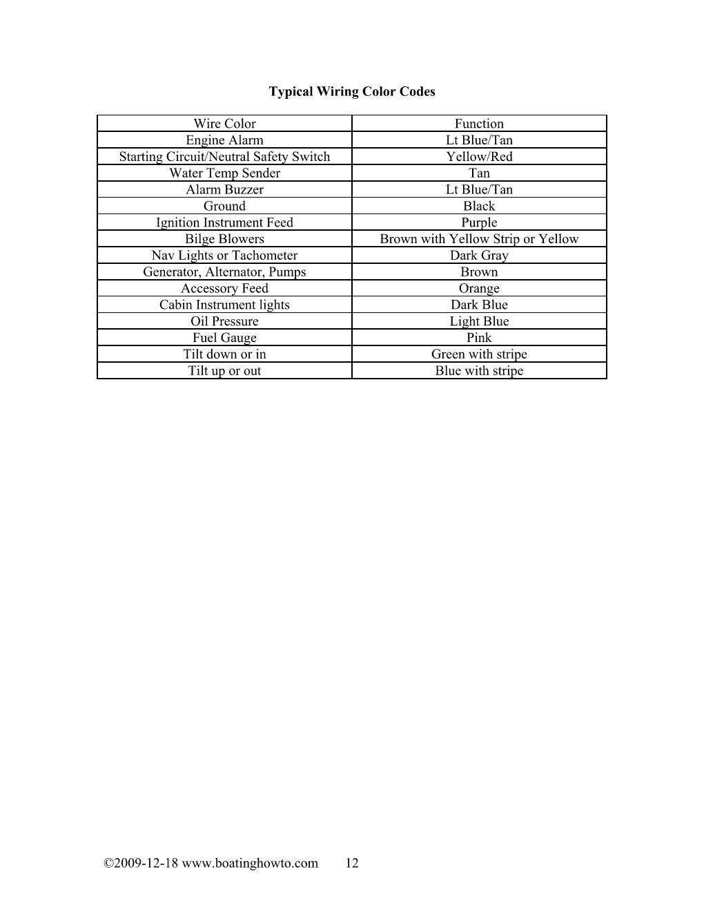

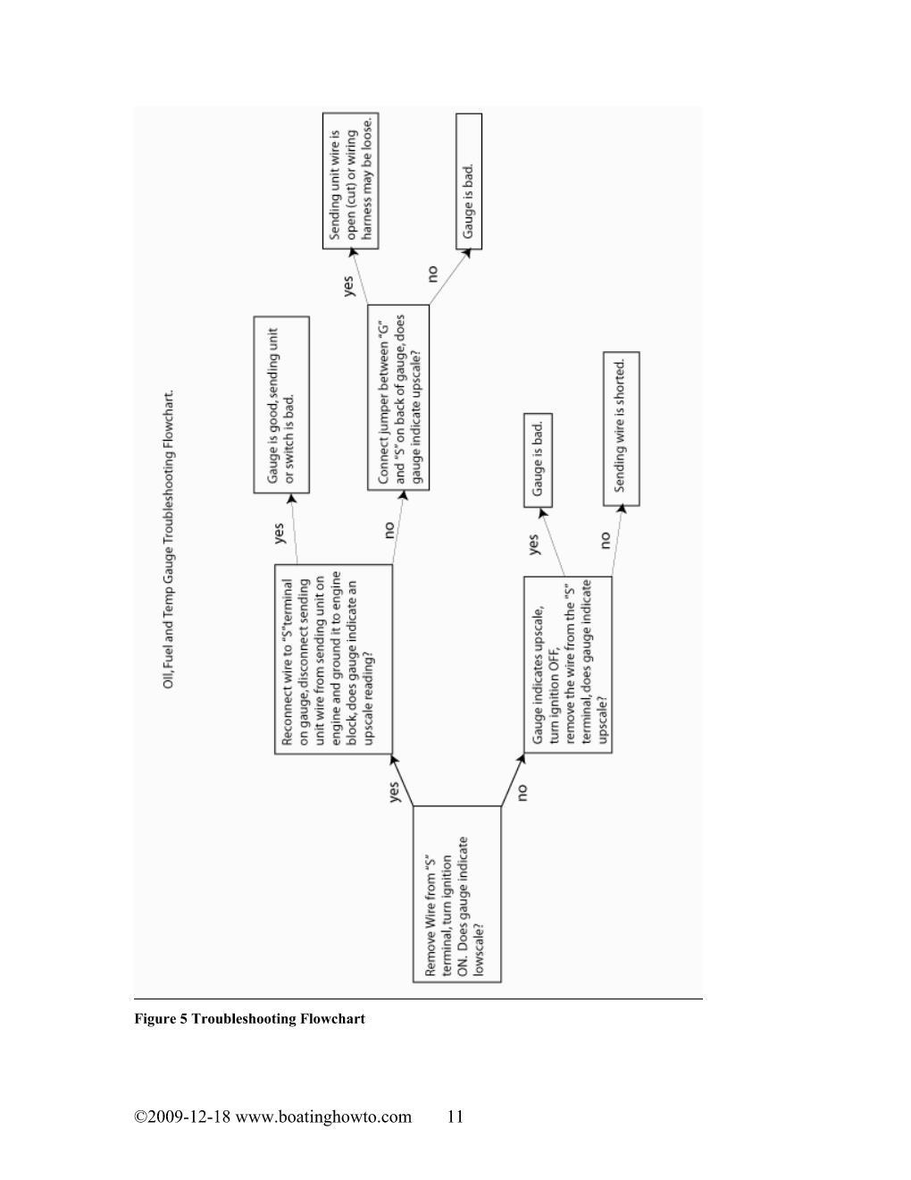

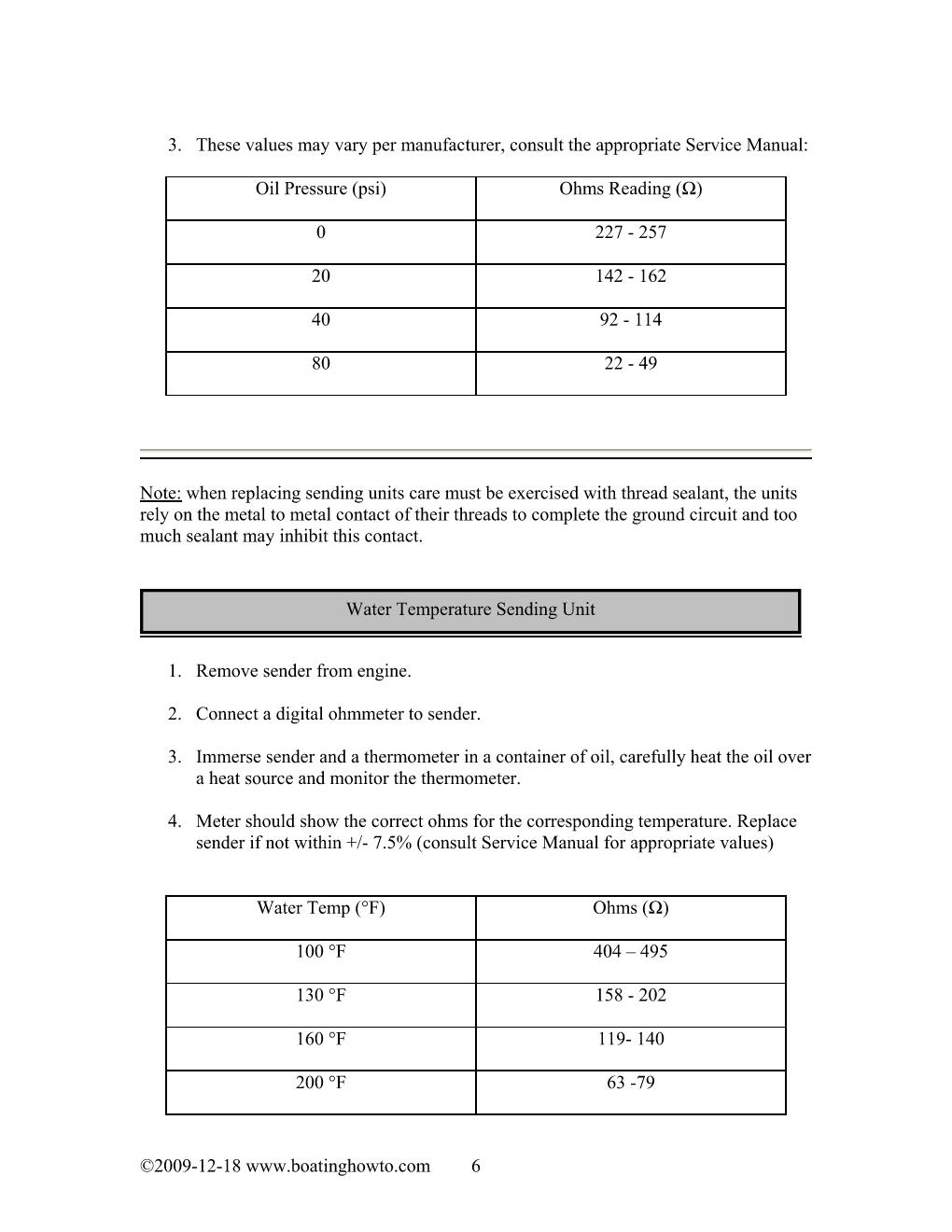

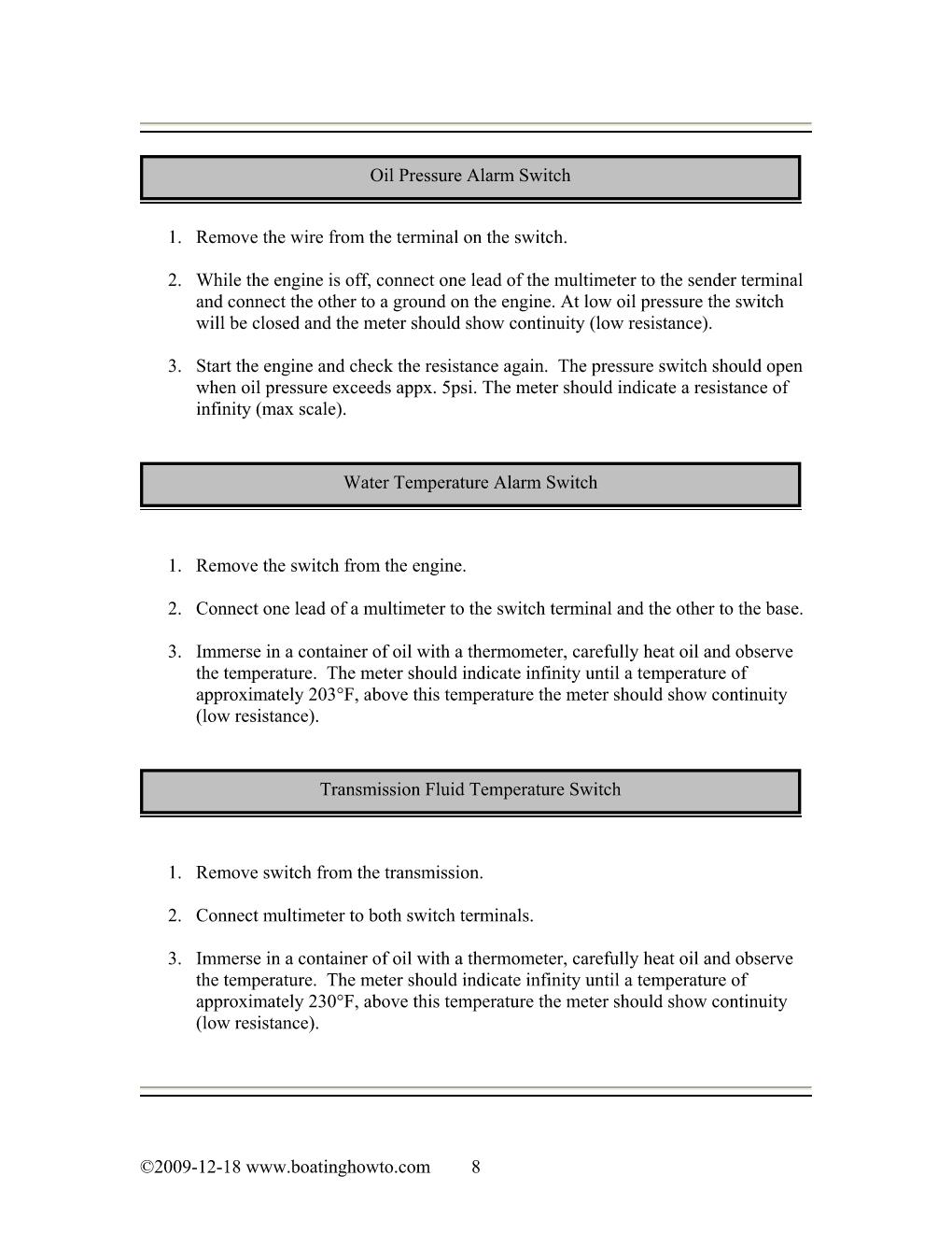

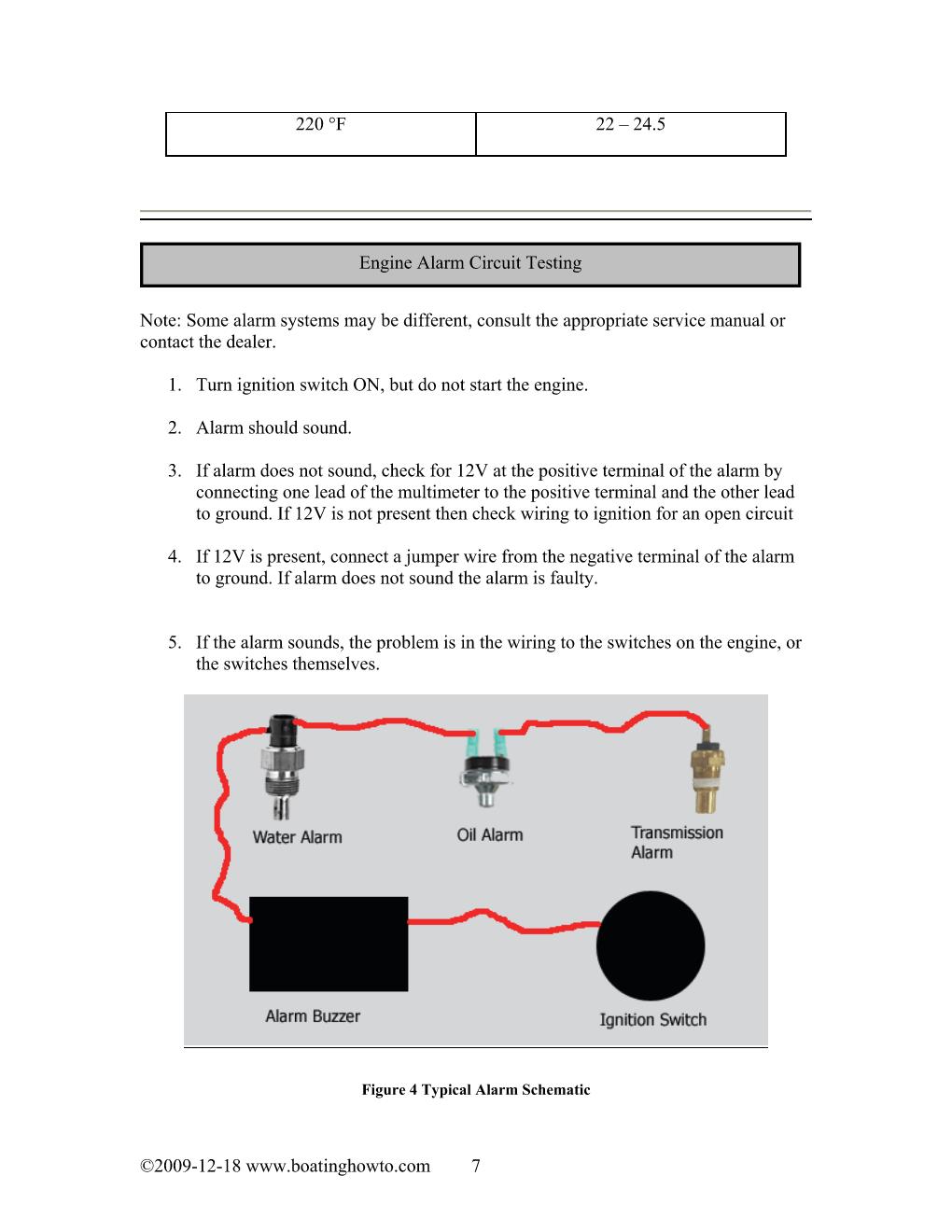

#2 Post by curtiscapk » Tue Jun 06, 2023 9:59 am
These should help
troubleshooting_pesky_marine_gauges Page 005.jpg (150.26 KiB) Viewed 17106 times
troubleshooting_pesky_marine_gauges Page 006.jpg (111.56 KiB) Viewed 17106 times
troubleshooting_pesky_marine_gauges Page 007.jpg (98.18 KiB) Viewed 17106 times
troubleshooting_pesky_marine_gauges Page 008.jpg (131.75 KiB) Viewed 17106 times
troubleshooting_pesky_marine_gauges Page 009.jpg (132.49 KiB) Viewed 17106 times
troubleshooting_pesky_marine_gauges Page 010.jpg (35.31 KiB) Viewed 17106 times
troubleshooting_pesky_marine_gauges Page 011.jpg (65.21 KiB) Viewed 17106 times
troubleshooting_pesky_marine_gauges Page 012.jpg (81.6 KiB) Viewed 17106 times

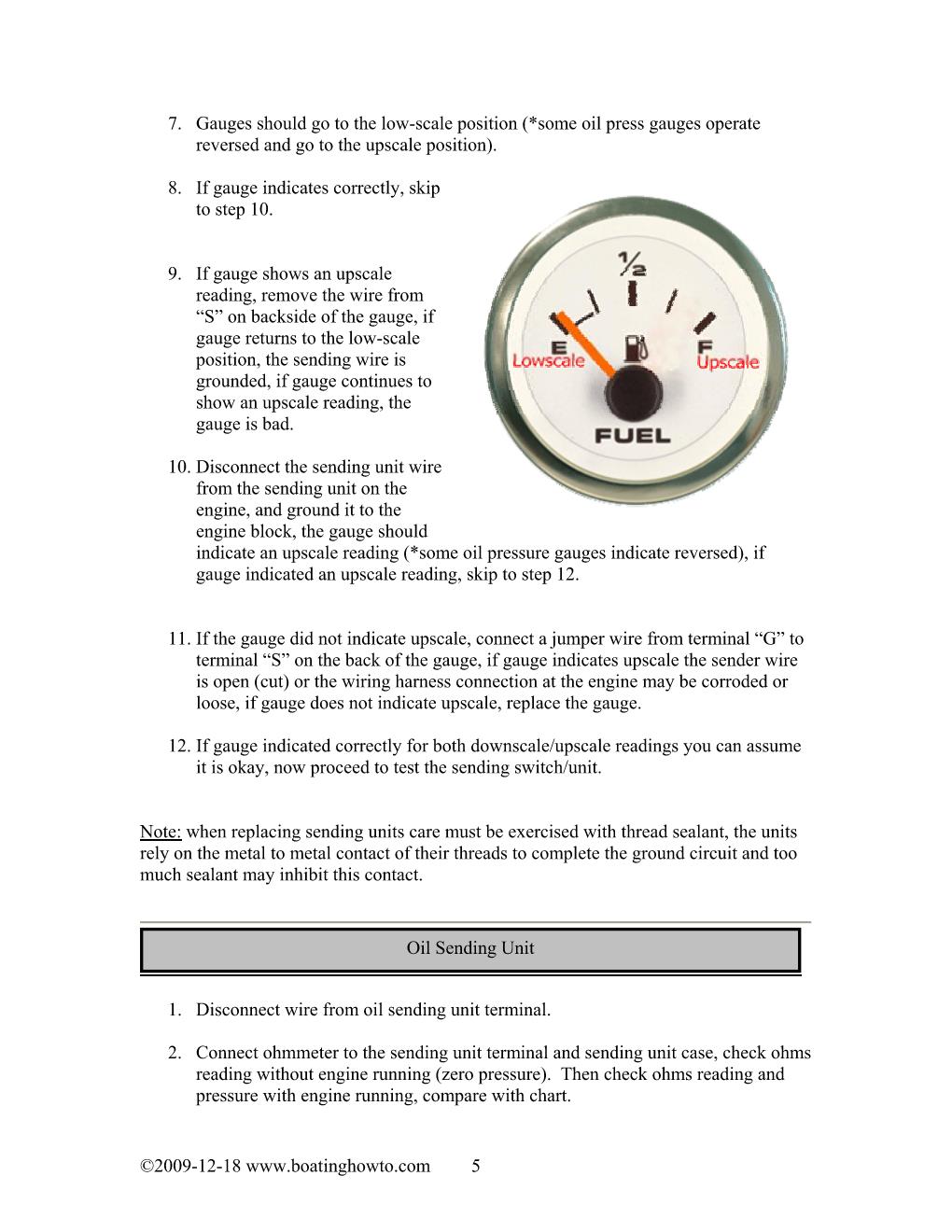

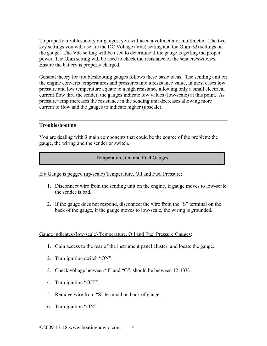

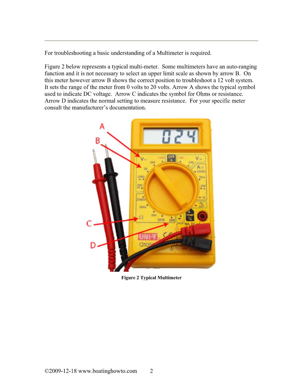

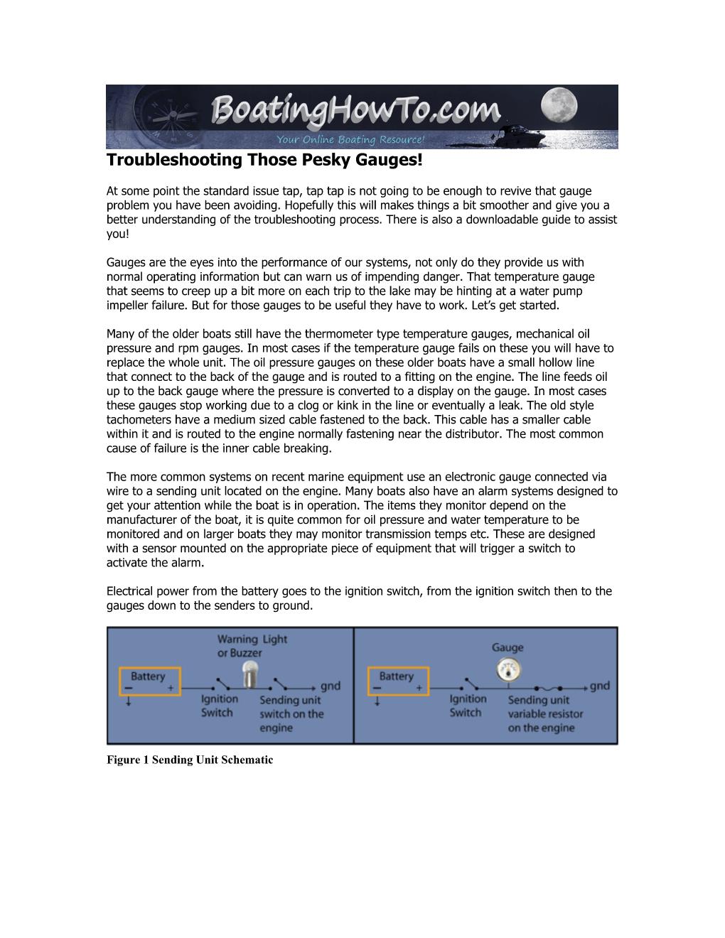

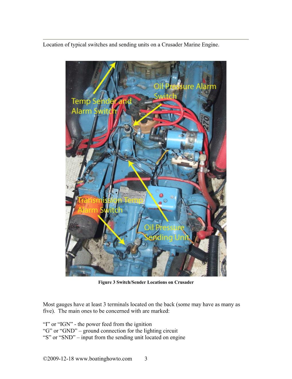

#3 Post by curtiscapk » Tue Jun 06, 2023 10:00 am
more here
troubleshooting_pesky_marine_gauges Page 001.jpg (190.57 KiB) Viewed 17106 times
troubleshooting_pesky_marine_gauges Page 002.jpg (100.9 KiB) Viewed 17106 times
troubleshooting_pesky_marine_gauges Page 003.jpg (137.37 KiB) Viewed 17106 times
troubleshooting_pesky_marine_gauges Page 004.jpg (147.22 KiB) Viewed 17106 times
