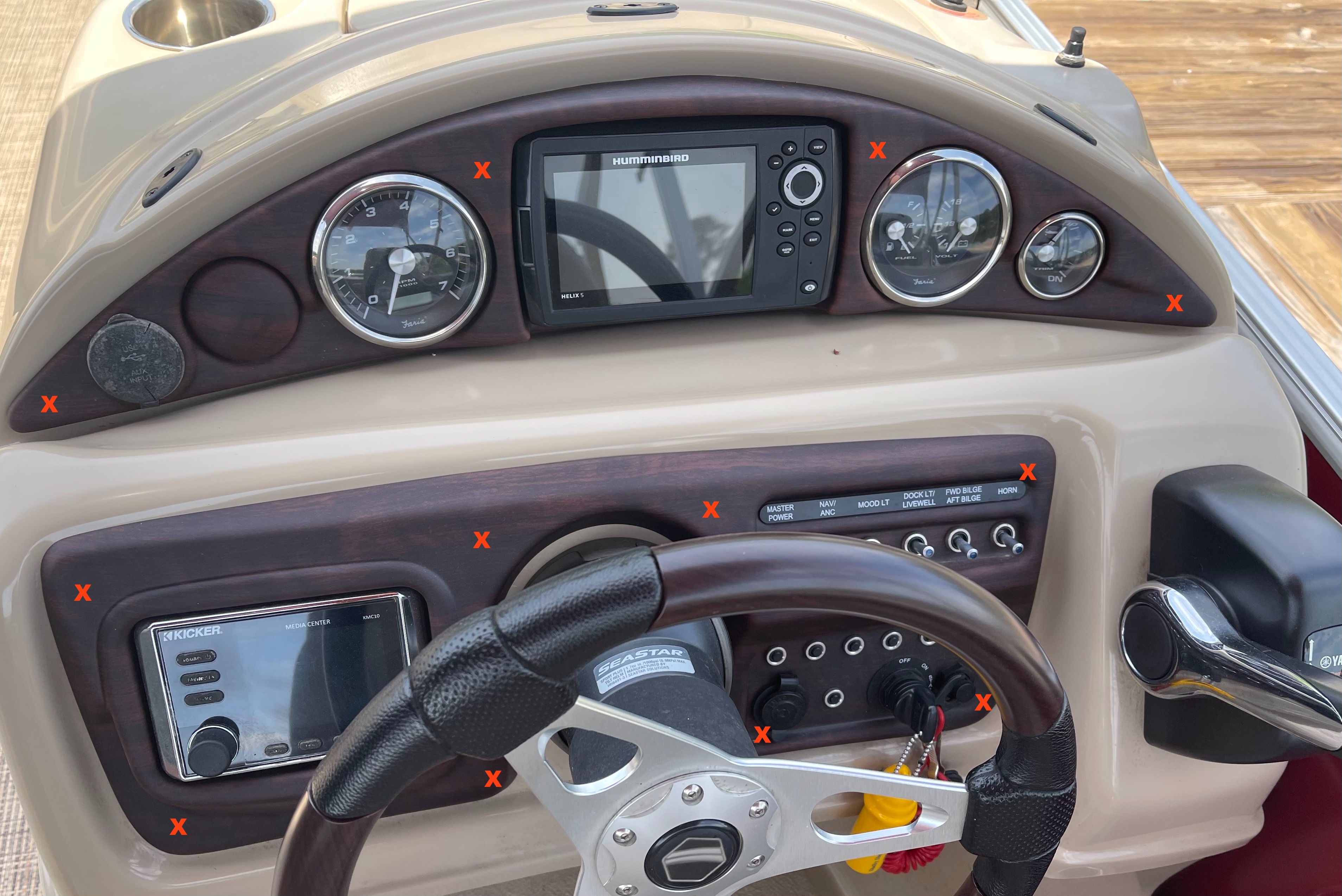

Is this a case of poor engineering in order to cheap out or is there a valid reason why these panels are attached using epoxy rather than hardware?
Both of the instrument/gauge panels on our 2017 South Bay 521CR are loose. The panels are attached to the fiberglass console by means of flat head screws that are (or were!) epoxied to the back side of the aluminum panels. I noticed one panel sagging and found that many of the screws have broken loose from the back side of the panels. I've filed a warranty claim hoping for a goodwill repair, but haven't heard back and don't expect them to cover it. The dealer's recommendation is to repair it in the same way but using Marinetex, "which will hold up better than the epoxy South Bay used". Stainless sheet metal screws, or machine screws with nuts, going through the panels from the front side into the fiberglass just seems so logical to me, is there a reason why I shouldn't install stainless screws at the red Xs? I do realize that it woulfn't look as clean and finished but I think there's a way to make it look ok with painted trim washers or screw covers. Maybe there's a structural reason that I'm missing? Any experienced advice for me?

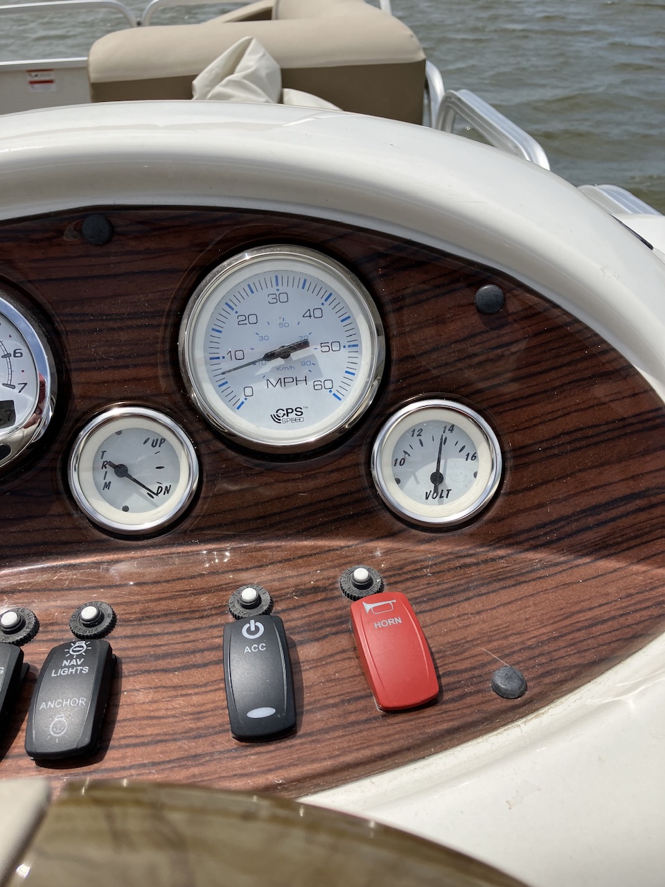

I think they just wanted it to be purty and the execution was not the best. My cluster is held in with oval head screws. I tried to lighten up the pic so you can see the dimples.
