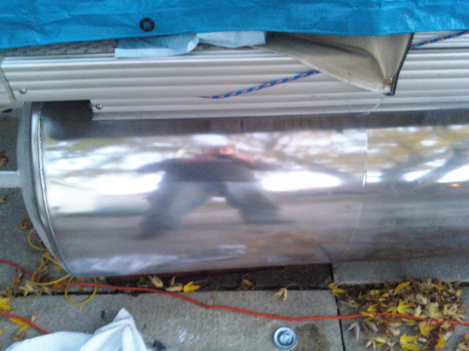

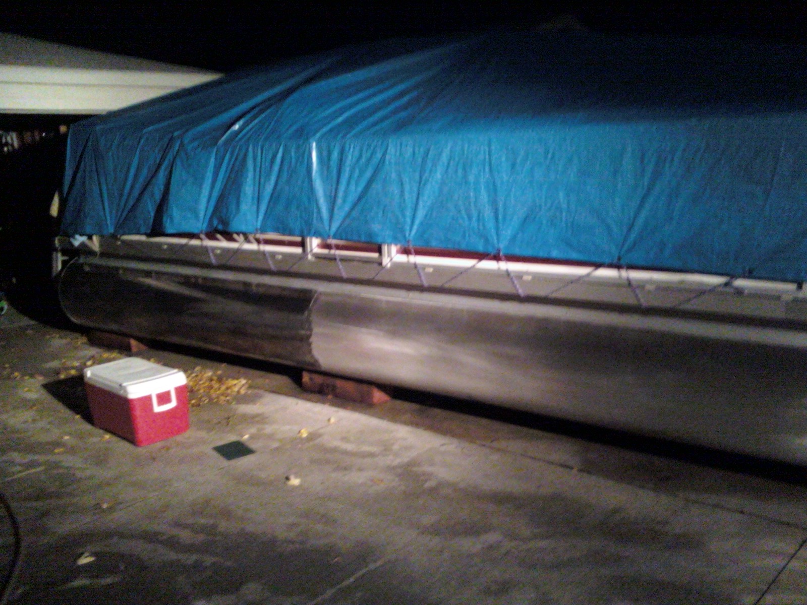

Ok so I got one side done, and it started to snow, so I wanted to hurry & apply the sharkhide, as I am wore out, & the sharkhide says apply 20-100* F but the colder the better. Turned out ok, happy with the top, closer to the bottom of the log doesnt look as good.
Ok ok I have read through all the toon polishing tips, and I'm outside busting my ass trying to polish them for the 2nd time this year, this time sharkhyde products are being used. Can someone please give me their best step by step tips. I've aluminum cleaned it with sharkhyde, now I'm polishing it with sharkhyde, applying by hand and rubbing it in with my variable speed buffer. It's looking ok but no matter how many coats of polish it stll doesn't look perfect and I'm still getting black residue. Please help thanks Tom

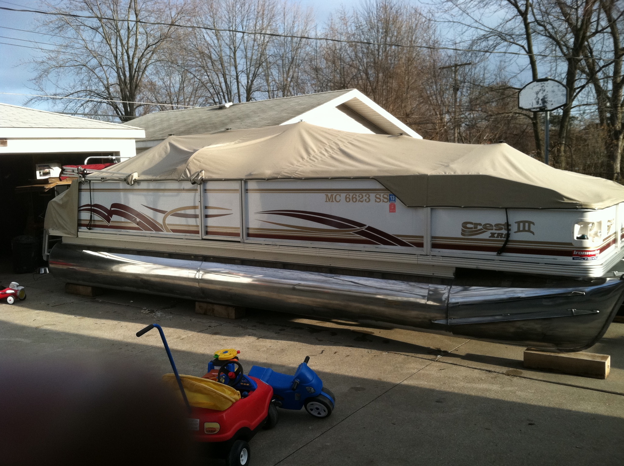

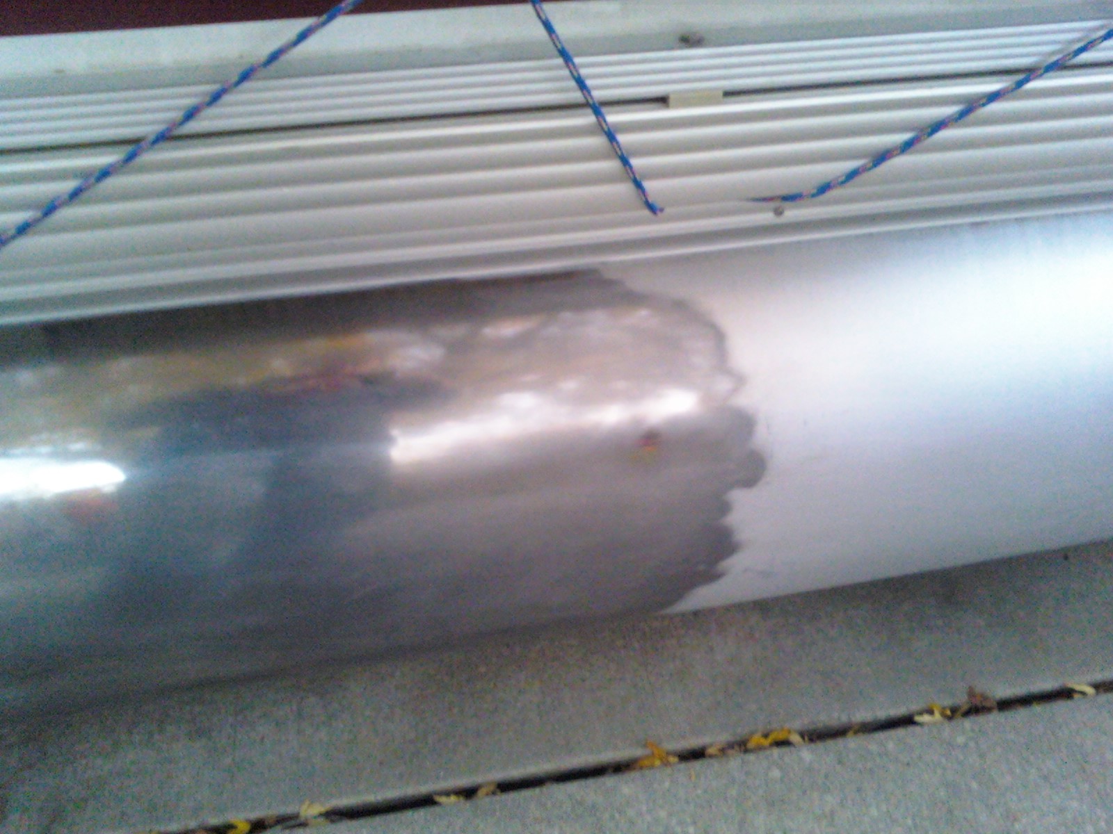

so here are some pics. They to me are a lil deceiving because pic 3 makes it look great, and in person it doesnt look that good. Thanks for all responses.

Just keep going, it is not a fast process, and the blacker you get, the better the toons will look, I don't know how abraisive shark hide cleaner is so I can't comment on that at all.
I use rouge and the other metal polishing sticks, they have differant grits for differant parts of the job.

dang bus I can see you in the reflection mine ain't close. Which I could help....

The sharkhide polish is non abrasive, so you will need wet/dry 400,600 an up to remove the blems, or you can use mothers or meguiars both are slightly abrasive. Sharkhide works great but won't take the blems out, since it is non abrasive. Far as the black residue mine never quit putting it out even when they had a mirror finish. Laquer thinner work best to remove the black although I have used acetone an mineral spirits. The awesome cleaner work good for cleaning the polishing bonnets. Have also used some dawn dishwashing liquid along with 000 or 0000 steelwool an will not scratch the finish like say an sos pad. Some use rouge but it didn't work nearly as well as the 3 polishes I mentioned. I would leave an deep blems or scratches since you will have to remove the metal down to them. When I ripped the end off my toon a while back was able to see the thickness of the walls an they are not as thick as one would imagine. Best to experiment with the methods I mentioned so you can get a feel for when you need more aggressive products in certain areas. Polished my first toon in 89 an have tried a lot of different polishes an such, but the things, I mentioned here worked the best far as shine an time savings.
