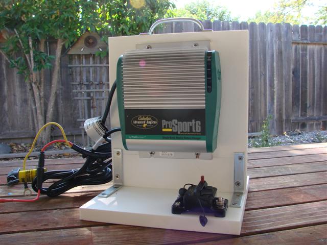

I have the 12v. 54lb Motorguide wireless on a 23 foot Sweetwater with a 115hp outboard. it works fine unless there is a strong wind. It came with the wireless foot control and I have a wireless hand-held aka FOB control which I love. I mounted it in the front myself and put the battery in a case up front so it's portable. I also mounted an onboard charger on a portable T type of stand with a 50 amp circuit breaker. I wire the motor to the battery through the breaker and it works great. Heavy guage wiring was expensive and I didn't want to run wires to the back of the boat. I bought the motor and charger at Cabela's. A 24 volt motor will certainly give you more power. I attached a picture of the portable onboard battery charger mount. The breaker is mounted on the lower right side.
- DSC00719 (Small).JPG (66.95 KiB) Viewed 5502 times
