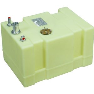

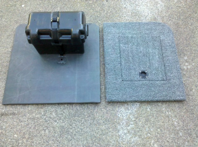

Here's the set up - minus the plywood bulkhead:
12 gallon tank.jpg (8.48 KiB) Viewed 7382 times
toon bat compartment.jpg (127.56 KiB) Viewed 7378 times

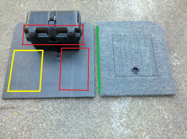

toon bat compartment.jpg (132.1 KiB) Viewed 7227 times
My boat has the same exact party hut rear as yours does just maybe a different year model. Anyway I changed mine from the stock small hinged lid to a fully hinged cover (see green line above) which allows full access to some real nice real estate for storage. Mine also has the battery enclosed but I placed it where the yellow square is located above. Instead of a permanent extra fuel tank when we go on extended outings I place a couple of six gallon fuel cans (red above) in the compartment for extra fuel. Plus I then have portable containers should I need to walk to a close onshore gas station for fuel replenishment which I've also needed to do a time or two. As an added plus there is still room to store a few bumpers on top of everything and still close the lid.
I also modified the other main fuel side with a fully hinged cover and also modified the fuel tank fill to straight up. This way I can just lift the lid and easily pour the extra fuel directly into the fuel tank with far less issues or concerns about spillage. I also had room for and the access to install the fuel water separator in the compartment above the tank also. Plus there seems to always be a bumper or two stowed away in there as well.

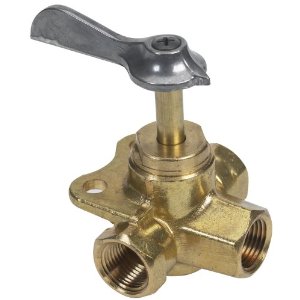

What you are looking for is a brass "3 way" fuel shutoff valve.
It is basically a "T" style ball valve with "A", "B" and "OFF".

Brass 3 way valve - previously used on a single tank with main, reserve and off. Now my 29 gallon will be "main" and the 12 gallon "reserve".
brass valve.jpg (13.54 KiB) Viewed 7128 times
