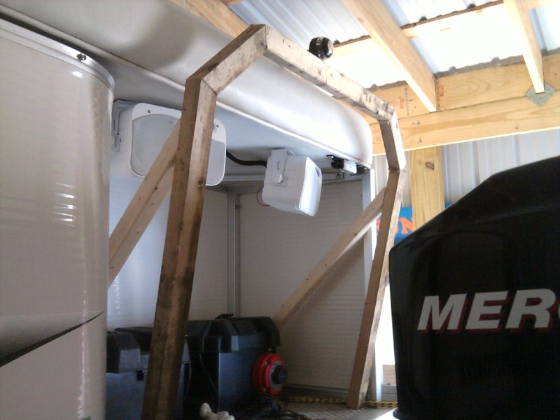

Here is a mock up built out of wood to get all the angles and dimensions. That way I can get a cut list and know all the lengths and angles.
Basically what Curtis has on his, but I'm gonna make it out of round tubing for more of a factory look. I'll just paint it for this summer, then maybe this winter I'll get it powder coated.

The bottom will have a flat iron running from the front support to the rear support. That flat iron will then bolt through the crossmembers.

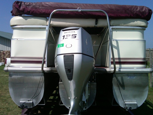

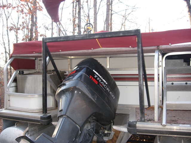

Re: Homemade ski/tube pylon-bar.
nice glad I could be of service! I would think I get a cut for design engineering!
- IMG_1365a.JPG (156.31 KiB) Viewed 30944 times

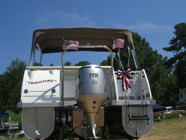

Also factory installed but works great.
- 9429_1219923894971_1135133719_665007_5386637_n.jpg (49.36 KiB) Viewed 30836 times
- 9429_1219924094976_1135133719_665012_4830365_n.jpg (52.3 KiB) Viewed 30837 times

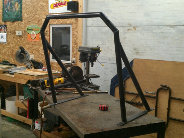

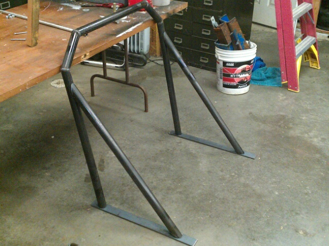

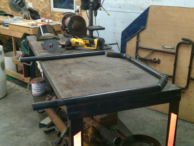

Finally got some time to get started on this. Been busy with work, but now since it rained AGAIN, can't get back in the fields for a few days. So figured I could get her done this week. Took about 3-4 hrs to fab it up and weld it. Now just need to figure out some type of rope mount. Then get some paint on it and bolt it on!!!
- IMAG0071_VGA.jpg (121.32 KiB) Viewed 30471 times
- IMAG0070_VGA.jpg (132.43 KiB) Viewed 30448 times
- IMAG0067_VGA.jpg (136.7 KiB) Viewed 30439 times

That looks Great! Here is a close up of my ring you look more than capable to fab it
- 100_0636a.jpg (117.9 KiB) Viewed 30358 times

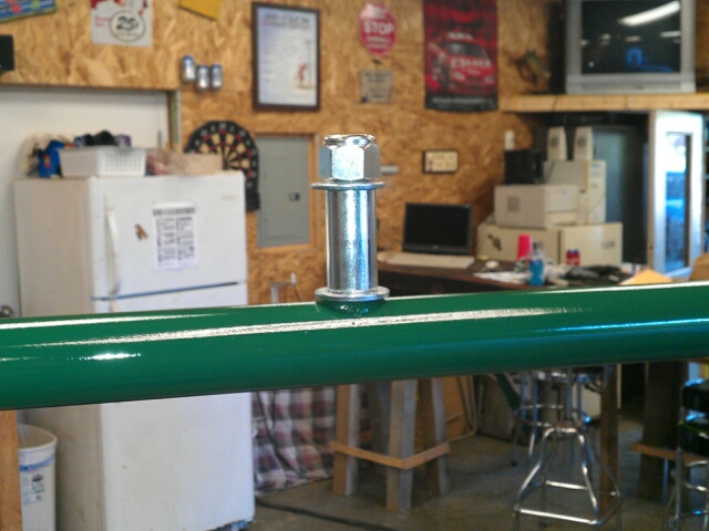

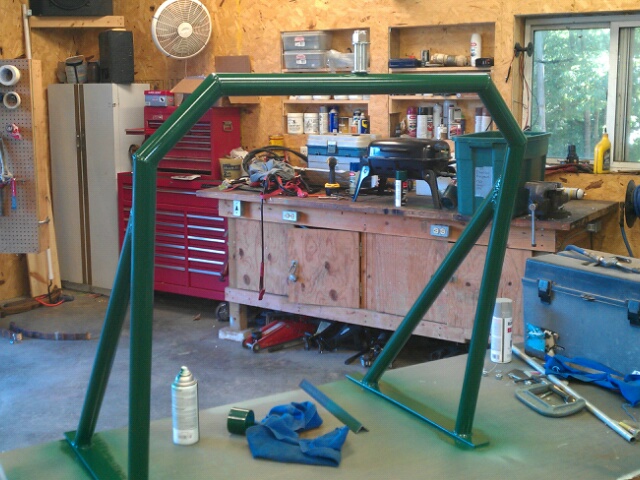

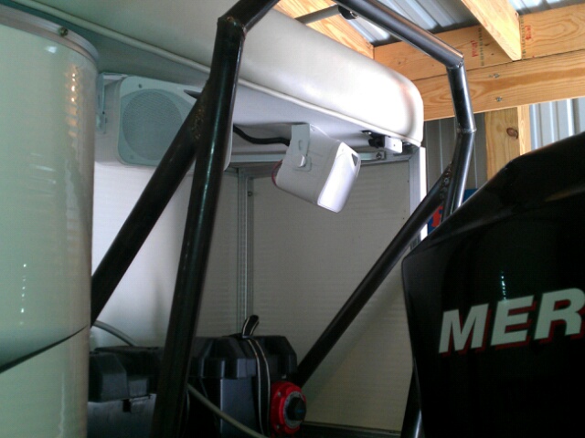

Here's some pics of it painted and with the rope mount on.
The rope mount I ended up welding a 3/4" bolt (cut the head off) to the top bar with a slight angle forward to keep the rope from trying to jump off. Then I found a bushing and put some washers on each side of it with a lock nut on top. This way the bushing can swivel so it doesn't wear out the rope.
