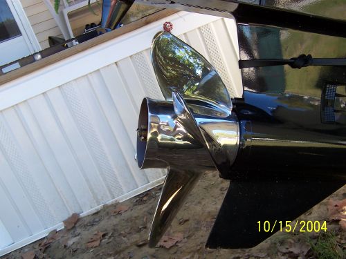

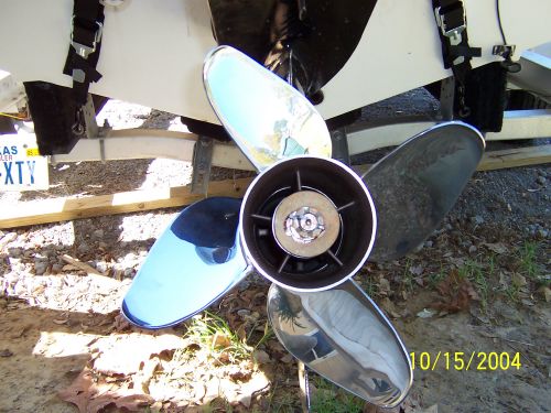

Didn't see this post till now. I'd be willing to bet Power Tech will recommend the OFX3 or the OFX4 for any of the big DFsuzuki's. I tested quite a few of their props on large group of heavy bayboats back in '02-'04,back when they first came out with the OFX. Was even a dealer then. I remember one boat with a big DF that we tried a 1/2 dozen known fast props on. Kept getting screwy data back until we tried an OFX4. Made a new boat out of it,and it was the fastest up to that point. Best we could figure is those big DF lower units punch a large hole through the water,and require a large dia. prop.
Personally I'd have to say the OFX4 was the best driving prop I've tried. Still have that prop on a shelf. Decent rake and tip cup carry the bow well,yet those long trailing edges lift the stern. Less blade surface and more cup than most big blades let it spool up fast and bite hard. Carried the whole boat higher out of the water. Worked great in rough water or carrying a heavy loaded boat. Used that prop a lot when I guided and fished tourneys. Wasn't a real fast prop on my boat running light,but probably the fastest loaded heavy and the most efficient. Also a good skinny water prop,as it would bite half way out of the water. Never tried it on a toon. Thanks for the report.
That blade has probably made PT more $$ than any other profile. As much as I wanted their props to test faster,the yammy and merc props usually took them on topend. There's more to a prop than topend though. I will say that their 15 1/4" VMX 3 blade was the fastest 0-60 prop I ever ran,under 13 seconds on a 3500 lb. boat.
Re: Suzuki DF150 propeller

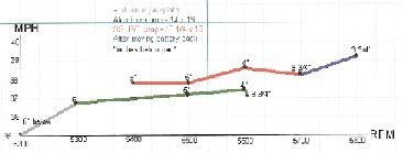

Ha, still have pics of Rob's DFsuzuki/OFX4.
Hard to make out,but I also found an old graph we use to fill out when testing props. Used the numbers from rpm,mph,and jackplate settings.
