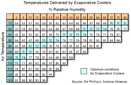

I like to deal in facts.
When it's 100F in Kansas and the RH is 5% evaporative cooling can reduce air temperature to 71F - that's significant.
When it's 100F in Kansas and the RH is 50% evaporative cooling can reduce air temperature to 88F - still not bad but you're approaching the limits of it's effectiveness. You begin to feel "clammy". 50% is about when thunderstorms can start happening big time.
Once you get into the 65% range it really doesn't work at all and becomes annoying since you are literally soaking wet.
Misters aren't NEARLY as effecient as evaporative cooling.
However, introduce some air movement into the equation - enough to provide even a gentle breeze and it helps dramatically - "wind chill" on your skin feels good. Unfortunately on a boat, the wind you generate by moving through the air (even at trolling speed) will disperse the mist.
I think the op's idea is excellent - but on a hot and sultry day while fishing or hanging out you're going to feel a lot more comfortable with the misters off.
