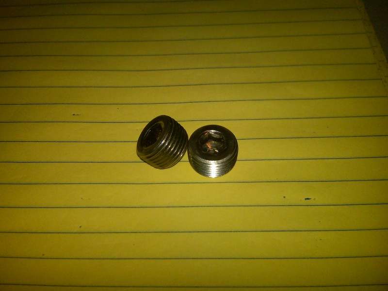

I went to Ace Hardware, didn't really see any stainless steel things that were comperable to the plug I have. Is there a place to order new ones? Or were you meaning to buy a stainless bolt that is the same size as this plug and use it?

#11 Post by The_Hellbilly » Thu Jun 30, 2011 12:06 pm
I bought mine from my local pontoon dealership.
plug pic 2.jpg (82.53 KiB) Viewed 17788 times
