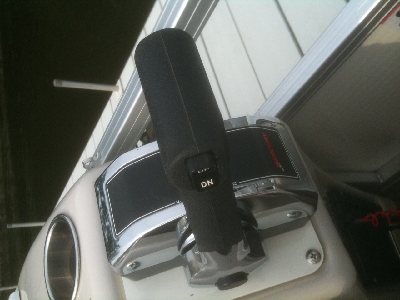

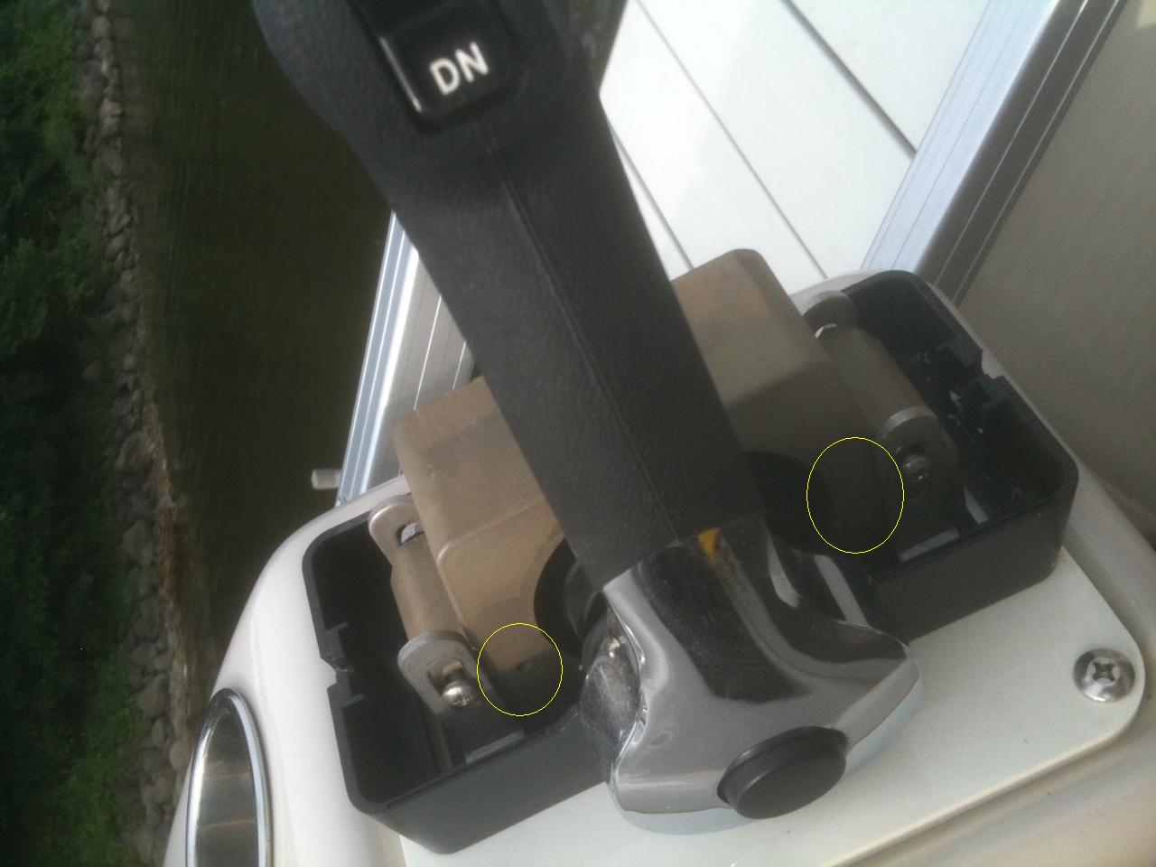

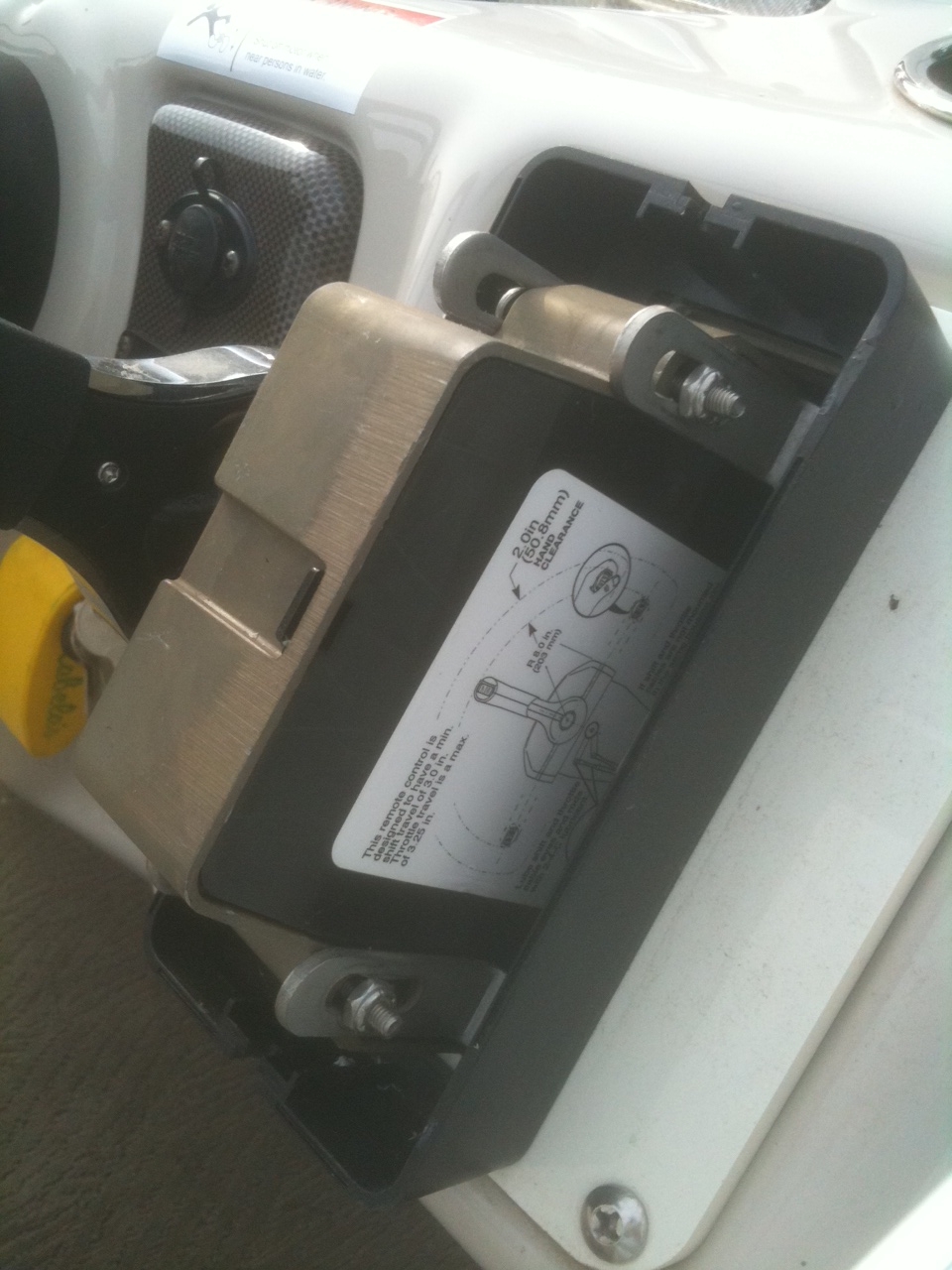

Took it apart this weekend and could only find 2 small holes. Is there a set screw or something inside of these holes? I didn't see anything obvious except these 2 holes circled in yellow.
Thanks in advance to advice in this matter.
- Control 3.JPG (91.12 KiB) Viewed 13219 times
- control 2.JPG (512.8 KiB) Viewed 13226 times
- Toon Control 1.JPG (320.65 KiB) Viewed 13235 times

Re: Adjusting Throttle Control Friction on a Merc
Just talked to Merc tech support. Lucked out and got a pretty decent guy on the phone. Sent him pics
Real helpful - the tech said it was either underneath the shifter in the console and there would be a screw there where the cables enter the control box or I have to pull the handle and there will be a friction adjustment there.
Anyway I'll check it next time Im up there
