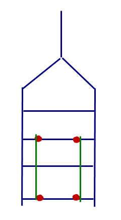

A quick fix would be to install 2 sets of posts (1 towards the front and 1 towards the rear of the trailer) about 6" in from the inside of your outer toons. Then install 2x4 boards (untreated) connected from the front post to the rear post (on the side facing toward the outer toons) -- cover those with carpet. These will keep the boat from getting over too far either direction on the trailer. The center toon should not hit either set of posts since the outer toon on the opposite side would hit the guide first.
Here's a sketch of what I'm talking about
- the blue lines are the trailer frame and cross bars
- the red dots are the guide posts
- the green lines are the guide boards

Thanks, that is something I was thinking of as well and is easy to do.

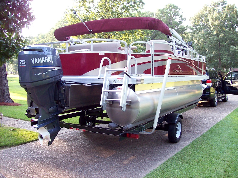

#45 Post by ROLAND » Sat Oct 18, 2014 3:20 am
The 4C innovation set up looks like a good one, but I haven't really found any need for it... The first year I had my boat I had nothing but trouble getting the boat on the trailer... Part of the problem was just learning how to do it, but I also added these pvc trailer guides to the back end of the trailer.... I just line up the right side of the boat about 4 inches inside the right trailer guide and she glides right on... works for me...
