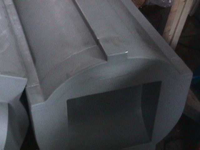

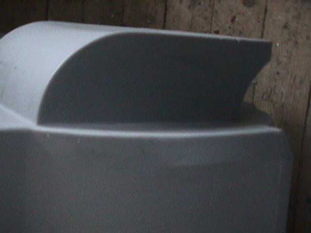

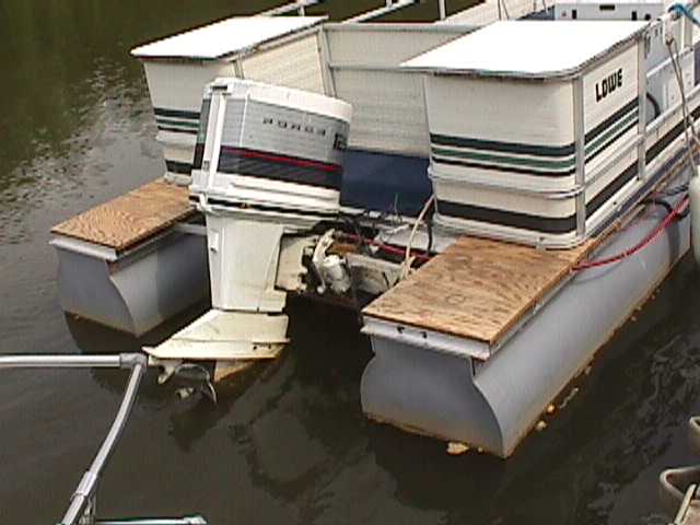

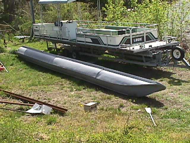

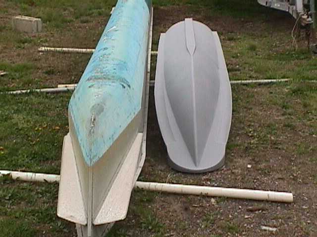

Here are some shots, I need to get close ups to show the mounting of them but here are some references...
- nt1.jpg (24.29 KiB) Viewed 33219 times
- Pontoon next to rest of boat
- MVC-011S.JPG (87.3 KiB) Viewed 33248 times
- nt9.jpg (35.26 KiB) Viewed 33256 times
- How hogh it is out of water now.
- MVC-015S.JPG (32.12 KiB) Viewed 33256 times
- part of "locking system"
- nt3.jpg (15.58 KiB) Viewed 33261 times
- Other part of "locking system"
- nt4.jpg (14.23 KiB) Viewed 33276 times
- Old boat on land
- boat1.jpg (71.4 KiB) Viewed 33280 times
