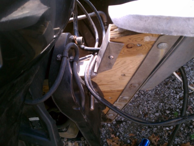

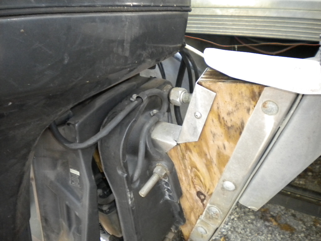

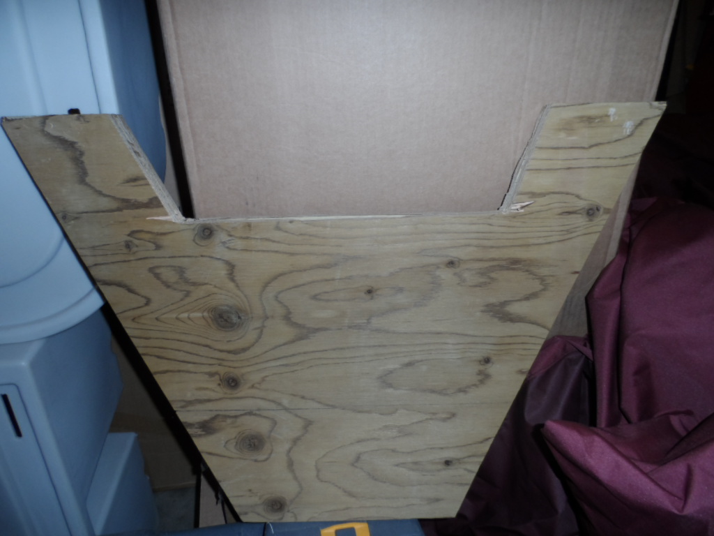

I am getting ready to cut the boards now. My question is how important is fiberglassing it???
THE FLOATER is never on the water more than 8 hours. Do you think if I use liquid nails and screws that would be good enough?
The previous owner just put the two boards together and bolted them in.
What do you guys think?

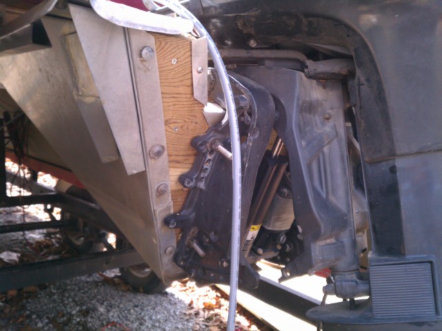

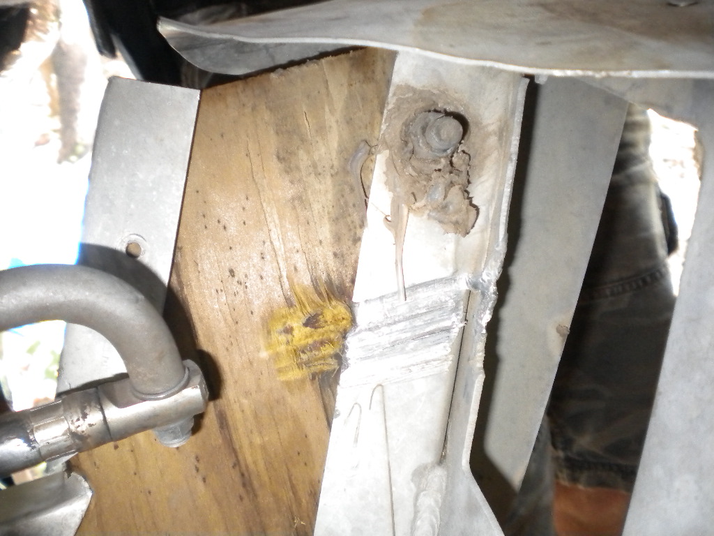

#92 Post by HandymanHerb » Thu Apr 18, 2013 5:03 pm
My wood is surrounded by metal front and rear, but still open to water on the bottom, but just the wood would work if it's marine grade, I was supprised mine from the factory wasn't marine grade and went to crap, so if it wasn't for the metal my engine would have hit the ground a long time ago

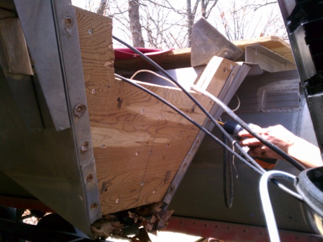

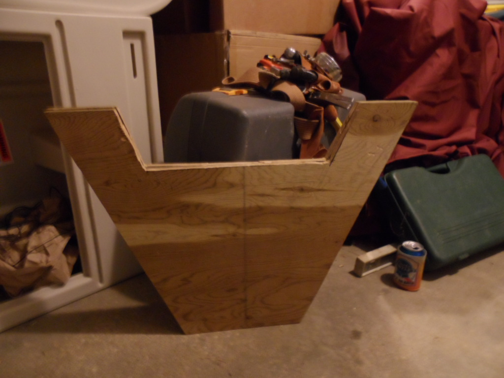

Well cutting the boards went pretty good!
Off by a 1/16th on one of the angles.... If I only had a table saw!!
I think its damn near perfect for a cordless skill and sawzall...

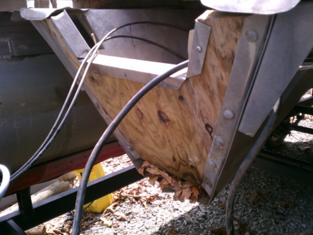

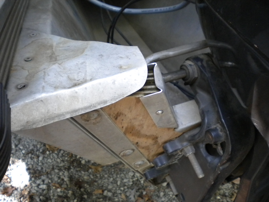

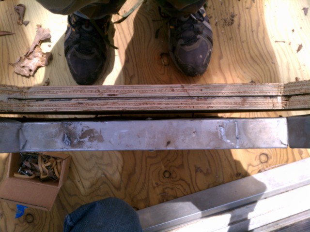

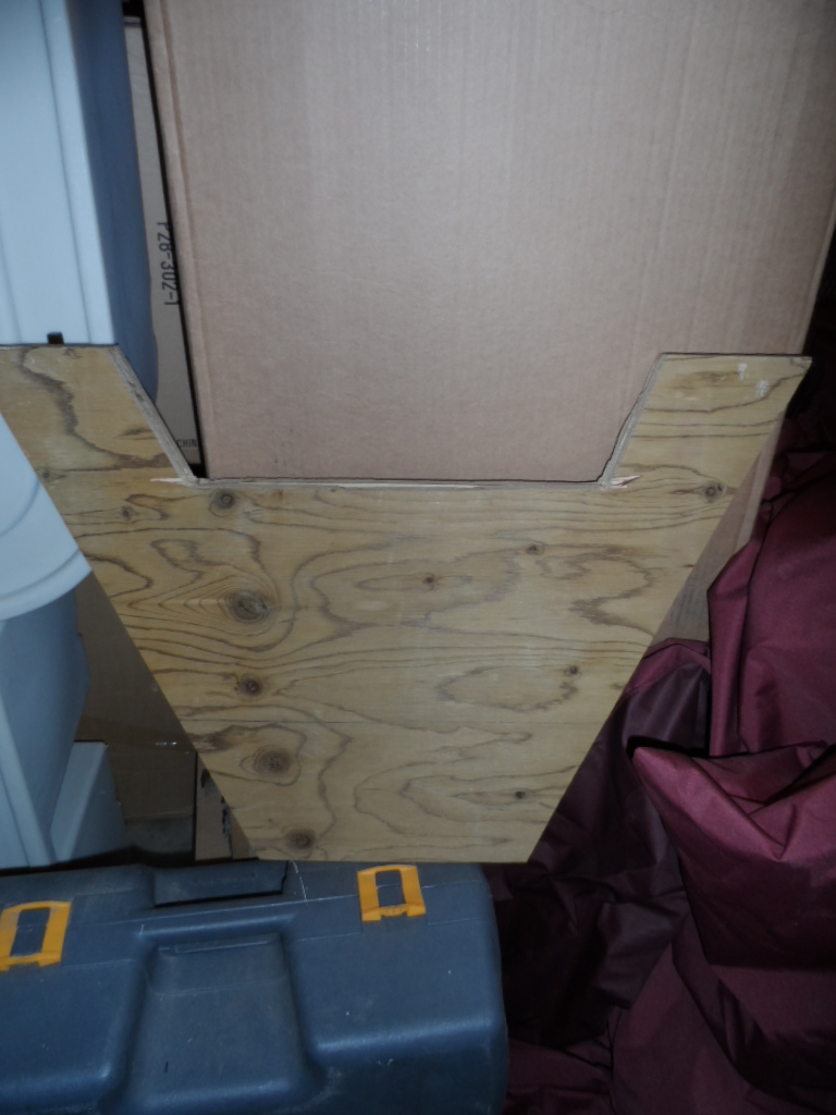

#94 Post by curtiscapk » Wed Apr 24, 2013 7:15 am
Even though the old one was sagging it was a bitch to get out!!! My initial measurements were almost perfect I had to trim less than a half an inch....

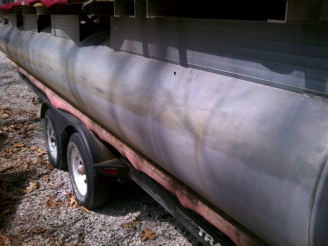

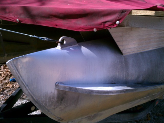

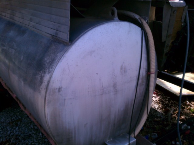

The toon cleaning didn't go so well I think I will try one more bottle. The front and very rear look good the rest black streaks I know I should try and sand them a bit.
Next weekend may be a go on the carpet....high 60's to 70's.. :prayer :prayer
We put a whole tube of liquid nails and 20 screws to join the two boards that transom is going no where!

Old one
New one

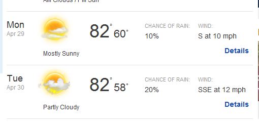

Well boys looks like the carpet is finally going down!!!! My daughter has her last gymnastics meet of the season this weekend for State Championchips, so I will be taking vacation on MOnday and Tuesday to put down the carpet. 80 both days and low of 60. I will be flying solo so we will see how that goes. I hope to have carpet down by noon on Monday and Ill try and clean all my rails while it dries. Then start on console, wiring and rear seat section on Tuesday. Wish me luck!

You can make your tubes look really good with SOS pads like I did to mine. I did an acid wash then hit them very good with the SOS pads being careful to hit every inch with a good even pressure then acid washed again. It will give the aluminum a nice new look but it will be a brushed finish.
