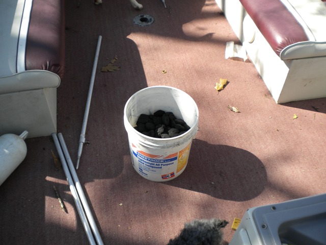

One other thing I do. Instead of using HumiDry, I use cheap charcoal briquets. I take them out of the bag and put them in a cheap plastic container. They do a good job of absorbing moisture and are a lot cheaper than the HumiDry.

Love the charcoal idea!!
