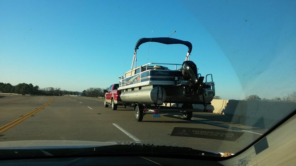

How to load/unload pontoon without getting wet?
My question is, how can I load or unload my toon without getting wet at the boat ramp. In order to get the boat deep enough for the backend to float I have to back down the ramp until my truck rear bumper is almost touching the water. If I go any shallower than that I will tear the bunk board carpet when the boat comes off of the trailer.
I go to lake Athens in Athens TX. The ramps descend at a normal rate and the lake is full.
I drive a 2007 Ford F150 and boat is a 20' Sun Tracker.
I didn't mind getting wet in the summer time. But this last weekend we went to the lake and the water temperature was 47 degrees. I know that all of you people up north really feel sorry for me, not, ha ha.
Any help would be appreciated.

Do you think it would help if my trailer was more level. Currently the trailer slightly points down at the nose. My thinking is if the trailer was more level that the back of the boat would be deeper in the water sooner, helping me to float sooner at a more shallow depth.

When your trailer is hooked up to your vehicle, it should always be level. Use a step up hitch that will raise the trailer tongue to level. That's what I do with my boat and '99 F-150.

why do you tow with your motor lifted up like that? doesnt that put stress on the transom? I always tow with my motor all the way down. Been doing it since 2003 never a problem.

hyper,
you can't tell from this picture, but I do have a transom saver rod that supports the lower unit to the frame. It came with the boat when I bought it last year.
