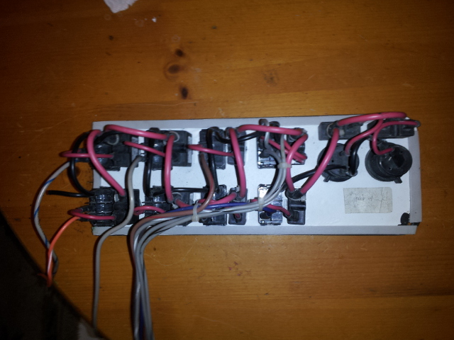

I have a good used switch panel but I'm a little confused about the wiring,all the switches have the postive [red] and negative [black] wires looping from one switch to another. I can understand the negative because it's a common grd but wouldn't looping the red defeat the purpose of individual fuses ? I've already install a fuse block[which is fed hot] and grd bar. Here's pic of the back of the switch panel,the red wire is easy to see the black a little harder.

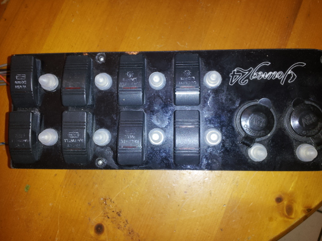

what does the front look like????? Does it have breakers on the switches?

Your answer just flipped a switch in my brain,duh. These round white things I thought were indicator lights are re-settable breakers,right ? All this stuff came in a box of goodies I picked up with another fuse block,grd bar etc. Here's a pic of the front.curtiscapk wrote:what does the front look like????? Does it have breakers on the switches?

BREAKERS!
All you need is a hot and Ground from your battery and they all go live...

Took a close look at your panel. Not bad.
Not sure of your wiring experience, but here's a few observations.
It appears as if the heavy red main feed to this panel will hook into the lower left breaker (in the photo viewed from the rear). It will hook into the tab showing just to the left of the heavy red wire. Don't use wire any lighter than that heavy gauge. On a longer run, you will need even heavier wire than the heavy red shown in the picture. If unsure, I or someone else here can advise on these numbers. I don't see what appears to be a master breaker or large fuse, so you should put one in the feed to this panel near the battery. Often times the main boat harness has a large feed forward from the motor which is breaker protected.
Not sure what the two round buttons are...possibly momentary switches (horn?), (bilge?). They also have breaker protection, so you end up with ten protected circuits-which is good.
The black wire is lighter gauge and likely only heavy enough to run the indicator lights on the switches. Don't use any of these black wires for grounding of circuits. Use a separate ground buss with heavy feed to it. Really anal marine wire pullers will put a breaker or fuse on the negative main feed as well, but I don't.
If you know all these things, then sorry for the overkill. If not, feel free to ask questions. There are others here with good wiring knowledge. We like to see people stay safe and there is often a lot of confusion in this very important area.

Come on Todd! those are cig lighters!
Re: Help with Switch Panel
OK ya got me.curtiscapk wrote:Come on Todd! those are cig lighters!
I couldn't see the depth of the sockets from the photo. You are certainly correct tho. Plus I don't smoke
Now what else did I screw up around here? Let me count the ways...

circuit breakers dont need a common. the reason there is a common is the switched have small lights in them when activated. JT
