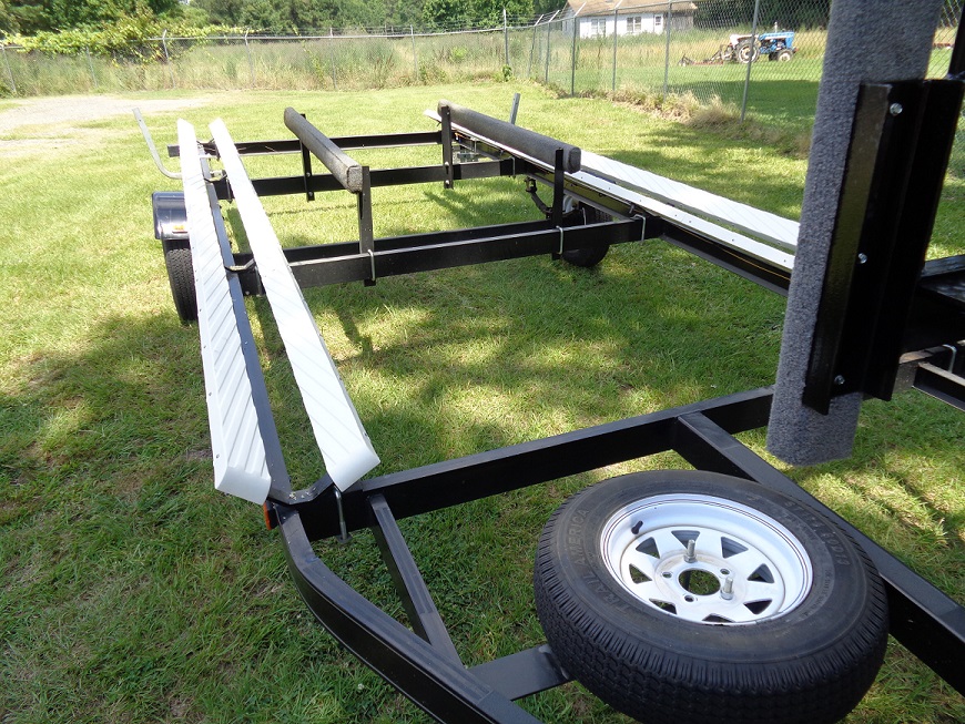

Yardbird... I re-did my bunks earlier this year.. I used pressure treated 2x4's... I went with plastic glide on's and now after reading all of this, I'm not sure what to think. But I do know that in my situation it's pretty much a moot point since I did cover my bunks with plastic.. you are right, it can get a bit pricey, but it will be a long long time before you have to fool with it again.. I bought 4 glide on kits.. each kit does 16' of bunks.. so it took four of them to cover all four.. total price for the glide on's was right at 229.00 But with no carpet, I expect the 2x4 bunks will last longer since there is no water retention and of course with plastic I never have to worry about carpet wearing and tearing.
I'm thinking more and more about how covering with a plastic would simply remove all of this from the equation. But with 64 feet of bunk to cover.... that stuff is pricey for a boat I only paid $3200 for (boat, motor, and trailer, 6 life jackets (practically new), flares, oar, anchor, lines...everything)
Anyways... got the carpet coming, a couple bits for the trailer lighting I wanna replace, new carriage bolts and hardware.... I'll get there. I have a few weeks to get it done
- New polymere plastic bunk glides installed and ready to go 6-10-2017 (6).JPG (327.13 KiB) Viewed 10738 times

Yardbird... I re-did my bunks earlier this year.. I used pressure treated 2x4's... I went with plastic glide on's and now after reading all of this, I'm not sure what to think. But I do know that in my situation it's pretty much a moot point since I did cover my bunks with plastic.. you are right, it can get a bit pricey, but it will be a long long time before you have to fool with it again.. I bought 4 glide on kits.. each kit does 16' of bunks.. so it took four of them to cover all four.. total price for the glide on's was right at 229.00 But with no carpet, I expect the 2x4 bunks will last longer since there is no water retention and of course with plastic I never have to worry about carpet wearing and tearing.[/quote]
And the plastic glide ons would be re-usable wouldn't they? I mean if you found a punky 2x4, you could remove the plastic, swap out a 2x4, and reinstall the plastic?

Re: Another trailer bunk question - attachment
I put this on another post. Cut the vinyl fence post covers in half, screwed them on the sides with stainless screws over treated 2x4's. $30 will cover 18' of bunks.
- 2017-06-08 09.56.15.jpg (65.91 KiB) Viewed 10716 times
