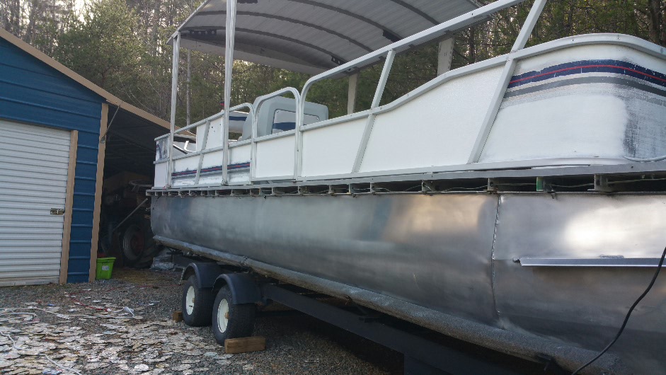

With all dr visits not much done, i got 4 panels sanded and painted...very pimp from 10 feet away...

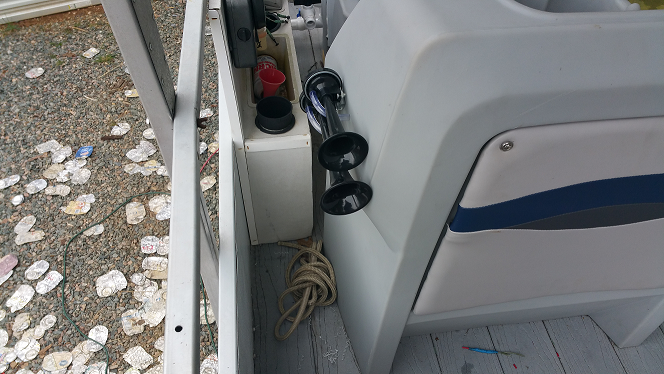

Also added air horn I had from another project, just cause
couple pictures...just because
ETA I will probably move the live well fill inside a few inches and move hose after looking at pictures, it looks vulnerable to damage if rear of pontoon swings out

Re: Bansil and MamaTurtle create a getaway cruiser
Looks great! you might want a cage of some kind over that pump? Just in case.....

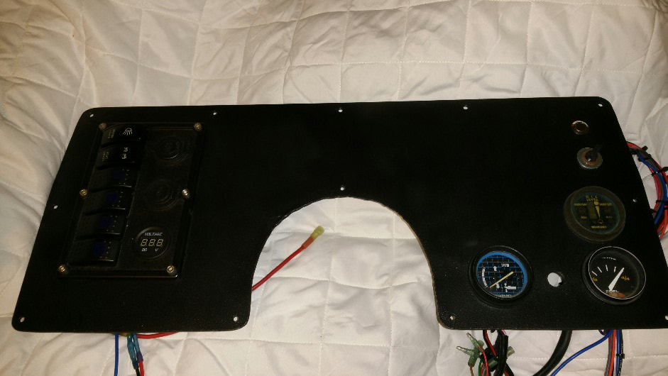

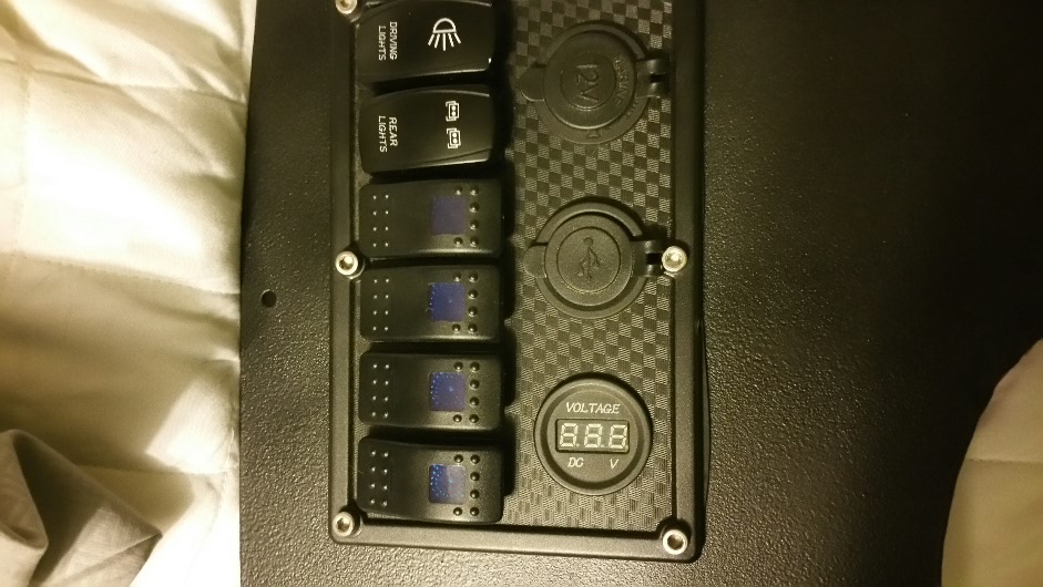

Got dash put together and now know what all wires go to what
Modified the basic switch panel by swapping out 2 switches and taking dremel to the double D's
So i had a round hole to index volt meter Top right
Horn
3 pos nav/mooring lights
Gags and n/off switch between bottom gages
Horn
