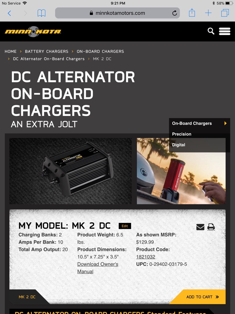

Here’s an email camp,e of an on board DC Charger I’m looking at. I hope someone has one that can advise on its performance.

Thanks Craig. I first heard of these years ago being used in bass boats to charge TM batteries. Websites also recommend them for pontoon boats. Any boat with secondary batteries should benefit from it, but how much is the question. Someone must have them...
