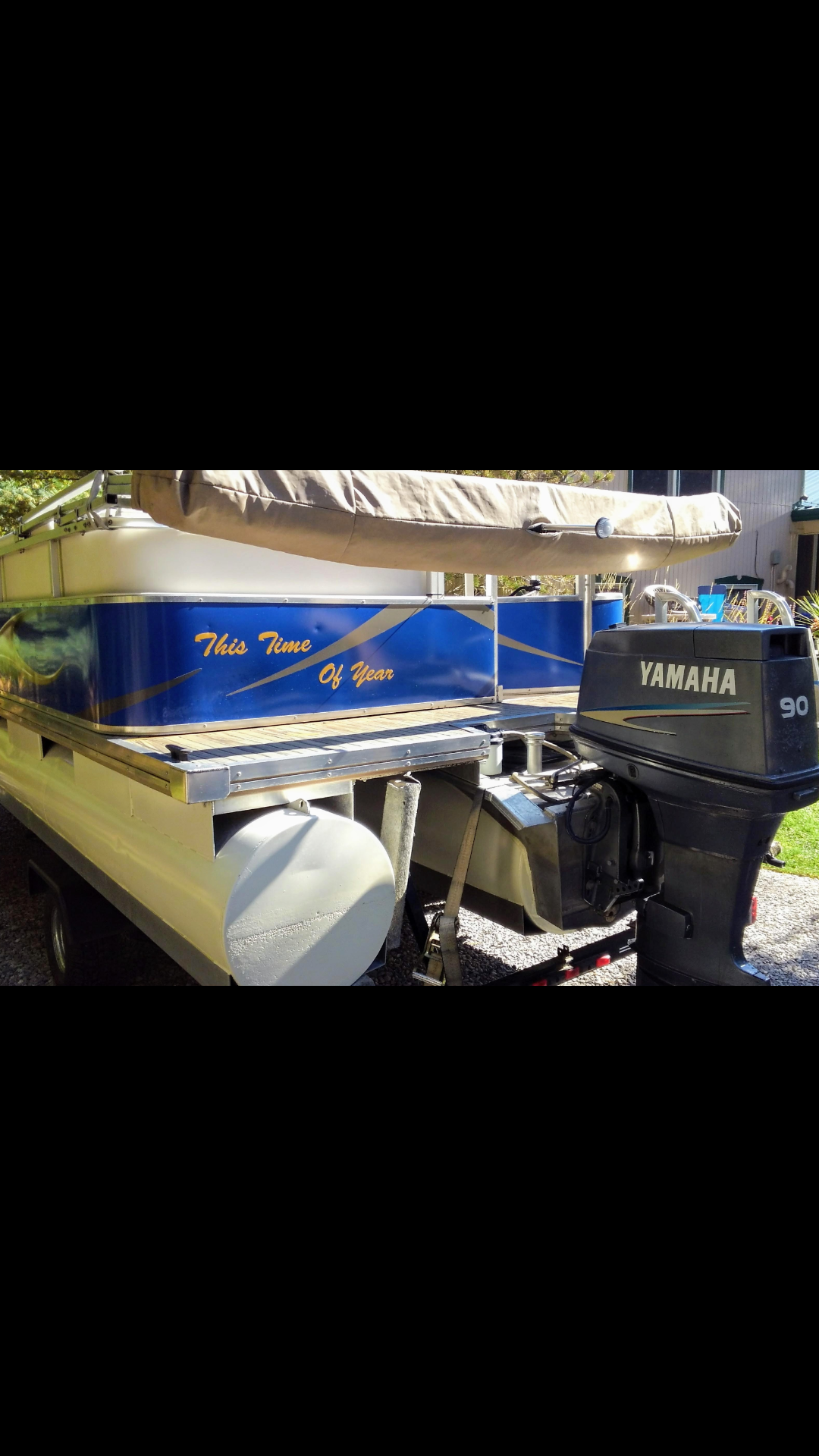

Well that brings back memories lol. I had the same exact issue with the 1983 I rebuilt. I cleaned and sanded just like you. It's where I got the idea to paint the logs. My boat boat lived on a trailer so I didn't use a bottom paint. I love how easy it is to clean painted logs. That said my boat is never in the water for more than a week straight when on vacations. I just wipe them down with vinegar water.
I liked the look of paint and ease of cleaning so I did it painted the logs on the new boat lol. Here's a picture of the old one after nine years of use. You can see the texture on the back of the log still. For some reason that was the worst on mine.

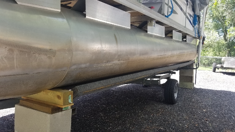

by onlybillhere » Mon Jun 22, 2020 12:26 pm
- 20200622_152051_resize_70.jpg (288.49 KiB) Viewed 2738 times
So the pontoon is officially off the bunks...
The bunks can be easily removed which I will do just to sand down the toons then replace them just to provide some extra security just in case the pontoon shifts off the blocks.
