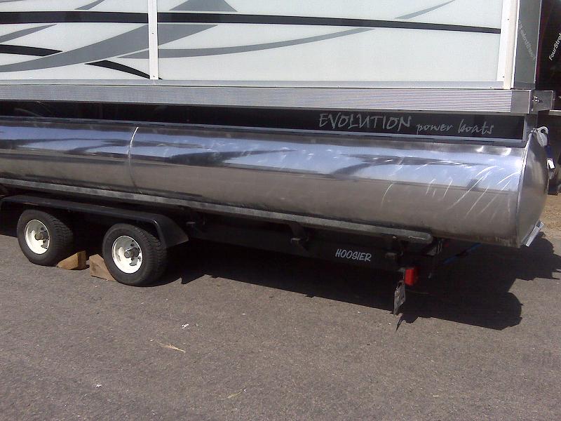

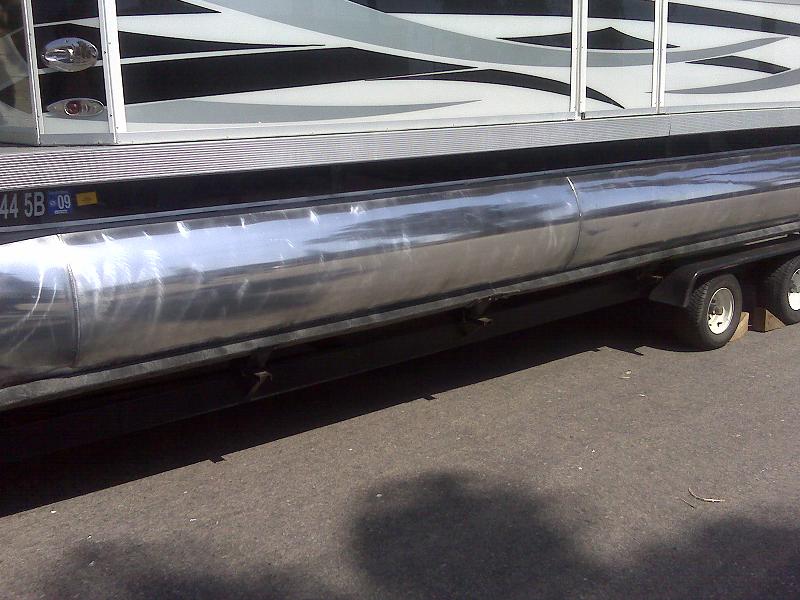

I finally polished the toons and the looked great until I pulled the boat out of the backyard. There are swirl marks all over both toons. I used a standard buffer with a wool pad and used 3M marine aluminum polish. I am not very happy with the look and may very well be doing them again. Any suggestions?? Thanks...

Wipe them with mineral sprits and see what happenes

I like the micro fiber pads for finish work. Swirl remover might work but some of the powermetal stuff at Autozone or advance auto should do the trick. Need a slightly abrasive to remove the swirls. I just went straight micro fiber (the blue) pad doing mine an never got the swirls. Should be a quick fix with either mothers or meguiar.

Mineral Spirits isn't going to touch those swirls. They are in the metal, not ON the metal. You need to go back over with a lighter compound/swirl remover. 3M makes a good swirl remover made for dark colored vehicles ( which will work good here to because swirls show up easier on dark cars/polished toons). I like to use Meguiars M205, which is soo fine that I have never had to polish more afterwards to remove swirls. Also, use a softer buffing pad. I like Lake country pads, and if you use a Blue/Red/Black pad, with the lighter compound, you should be good. My guess is that your wool pad did just as much damage ( swirl marks ) as the compound you used did. Wool is used for Heavy correction, not fine tuning.

might try a random orbital polisher too.

Thanks for the advice guys! I am gonna go over it this weekend with the swirl remover and orbital polisher and see what the results are..
