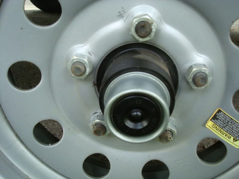

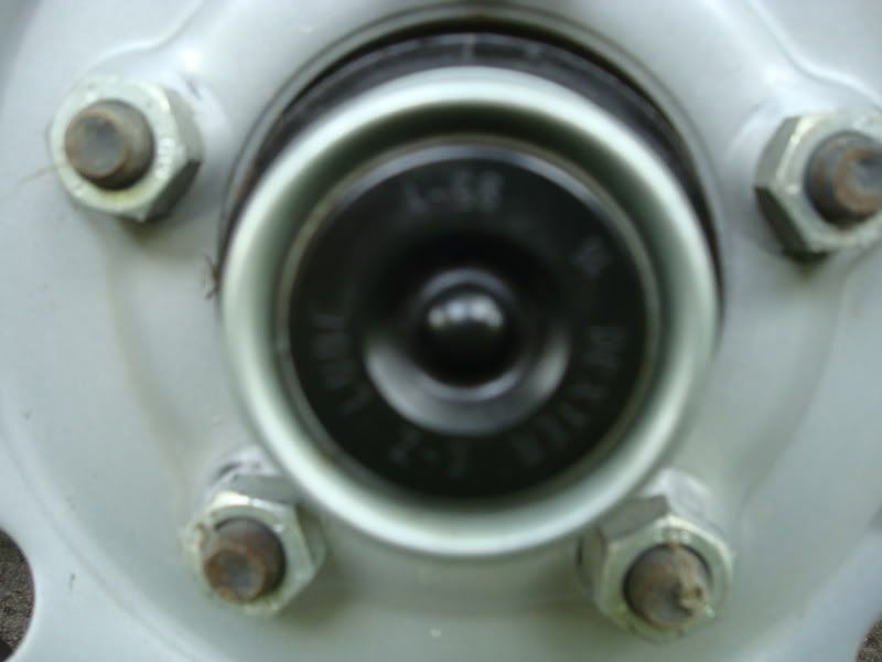

This is what I have, and as far as I can tell, they must be a sealed bearing.... I hope not, as I've never had good luck with sealed bearings, but if so, then I'll live with it. What do you think? I can't find anywhere to grease them, unless this little black cover pops off????

pull that black dust cover off, the zerk fitting is right behind it and pumps the old grease out when you shoot the new in.

Yes the black piece pops out and there is a grease fitting behind it.
You jack the trailer up and add grease while rotating the wheel, it has worked great on the atv trailer so far.

Thanks for the info. guys. My dad actually happened to stop by shortly after I posted, and he just pulled the cover off without even asking. He said " Are you going to grease your trailer wheels" ? I say, " Well yea, if I can figure out how to". Then he showed me. I guess I need to have a little more faith in myself, and just start pulling covers off...
Only 1 pump, and nice clean grease came back out the backside. I gues I'm good to go. :alright

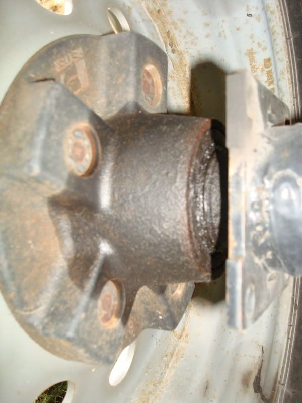

So...I remove the A/C compressor clutch to find this:
Run to Autozone, replace the (sealed) bearing and it's good as new. :rofl :rofl
