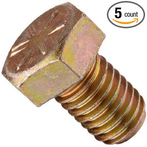

An interesting debate, but I am not convinced that the nuts pictured in the first post are brass at all. I believe what you are seeing is a fastener that has a chromate coating. Chromate coating is often used to passivate (spontaneous formation of a hard non-reactive surface film that inhibits further corrosion) aluminum and other materials. Here is a picture of a chromate coating on a bolt. Often mistaken for brass.

Yep. I was actually waiting for him to mail me a sample before telling him it's not brass though :rofl

That is why I hit both of them with a file. Look at the pictures again.
That chromate plating is usually used over steel and we know they aren't steel.
