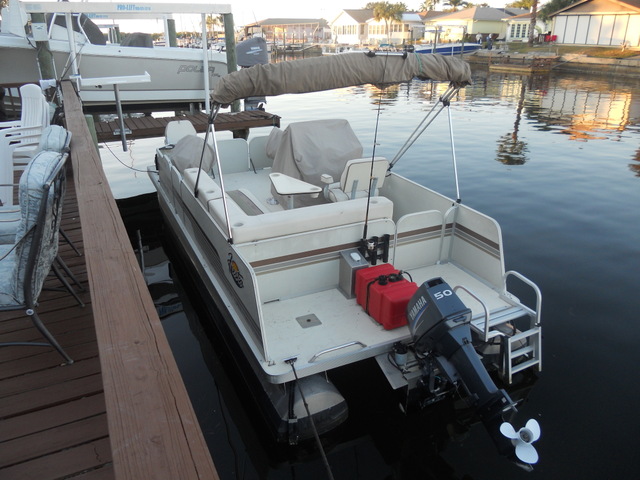

I'm glad you mentioned this because it leads into another issue I wanted to ask about. When I bought the boat I was the third owner. The original owner disconnected the stock fuel tank because he said water was getting into the fuel. He added the 12 gallon red tank that you can see sitting on the deck in the photo below.
The guy I bought the boat from said he thinks it was just condensation that was forming in the tank, and that I should reconnect the original tank, and use the red one as a backup. I want to do this so that I have more fuel capacity, but want to make sure there isn't a problem with the original. Is there a good way to check a fuel tank for water leaks?
The original tank is located just in front of the transom...derectly below the deck where the red tank is sitting. The bottom few inches of the tank sit below the water line so maybe this is causing the condensation. The aluminium box with the white gas cap sitting next to the fishing pole is where the gas fill up is located. Shouldn't the water/fuel seperator remove any condensation that forms in the fuel tank?
Red tank is secondary, original tank is below the deck.
stern view.jpg (165.99 KiB) Viewed 3682 times
Re: Optimal long distance cruise RPM's
#9 Post by badmoonrising » Thu Feb 24, 2011 7:35 am
If the tank was a problem in the past, it may just need a cleaning. Is it removable ? Is it metal or plastic ? Metal tanks can and do corrode from the inside. Especially in these days of ethanol fuel.
The only way to check it for leaks is to remove it and fill it partially, then watch for leaks. Also a common failure point is the in-tank check valve, lots of times the tank gets blamed when it's the valve that goes bad.
The water separating fuel filter should handle normal amounts of condensation. Metal tanks are more prone to this than plastic ones.

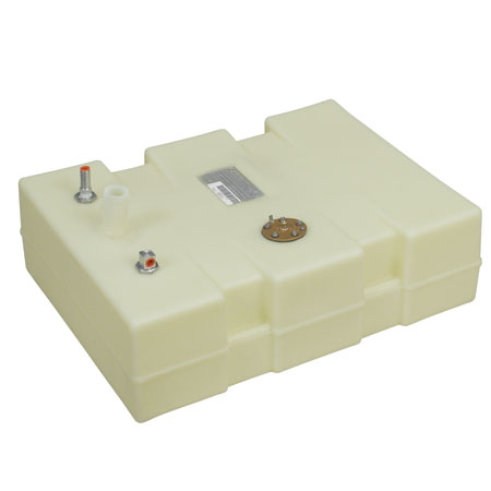

It's a plastic tank similar to the one below, but shaped differently. I don't think it is removable. At least not easilly. I don't really think the tank is the problem, but maybe water was getting in somewhere else. The guy I bought it from used only non-ethenol fuel. Can it be cleaned while still in place?
gas tank.jpg (14.38 KiB) Viewed 3630 times
#11 Post by badmoonrising » Thu Feb 24, 2011 7:51 am
It can be, but you'll get a more thorough cleaning if you can remove it. In the boat you'll have to use a siphon and be able to see inside the tank, looking for debris. You'll be amazed the amount of silt in the bottom of marine fuel tanks.
My old Proline had so much silt in it's tank it completely blocked the fuel filter. looked like sand (probably was). Gas station storage tanks aren't exactly the cleanest things, especially marina tanks. That's why Honda and other manufacturers add fuel filter strainers to their fuel fills, to keep the junk out of their products.
