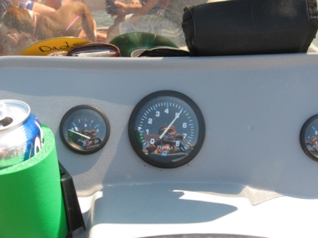

Re: Water pressure gauge hookup.
where do you mount the press. gauge?? in the dash or on the motor?
PLP Member
NRA member
UFC fan
PLP Member
NRA member
UFC fan
- Posts: 5441
dash
- hard to see but right gauge...yes I know my fuel gage is broken...
