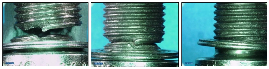

Here's NGK's technical bulletin - which directly contradicts Mercury's advice!
Topic
The use of anti-seize compounds on spark plug threads that have a metal shell
plating (i.e. Zinc or Nickel plating).
Issue
Applying anti-seize to the threads of spark plugs that have a metal plating allows the installer to mistakenly over-tighten the spark plug in the cylinder head; This stretches and fatigues the threads of the spark plugs, causing a much higher probability that the plug will break during installation or in some cases upon removal.
Example of 10mm thread spark plug broken during installation due to the use of anti-seize leading
to over-tightening. (Note that plug gasket has been completely compressed, anti-seize can be seen
on threads, and the break is in the direction of tightening).
Solution
For spark plugs with special metal plating simply do not use anti-seize on initial
Installation; All NGK Spark Plugs are manufactured with a special trivalent Zinc-chromate shell plating that is designed to prevent both corrosion and seizure to the cylinder head; Thus eliminating the need for any thread compounds or lubricants.
Additional Information
NGK recommends only using spark plugs with metal plating on all aluminum head applications to prevent damage to the head and plug. Metal shell plating acts as a “lubricant” which breaks away from the main body of the spark plug during removal, preventing damage to the spark plug and or threads in the cylinder head.
plug thread damage.jpg (169.64 KiB) Viewed 2428 times
(edited to highlight thread compound information)

#22 Post by GregF » Sat Sep 17, 2011 12:30 pm
Jesus, I just saw the pictures. Were they putting them in with an impact wrench?

GregF wrote:Jesus, I just saw the pictures. Were they putting them in with an impact wrench?
That's EXACTLY the issue I'm talkin' bout. Add a 20% or more increase in torque due to the anti-sieze and you've taken that 20Nm (14 ft.lbs.) up one heck of a lot. An extra 3lbs. of torque on what is basically a hollow cylinder instead of a solid rod is tremendous! :scared
I'm not making this stuff up - this is right from NGK's techinal bulletin. :coffee
