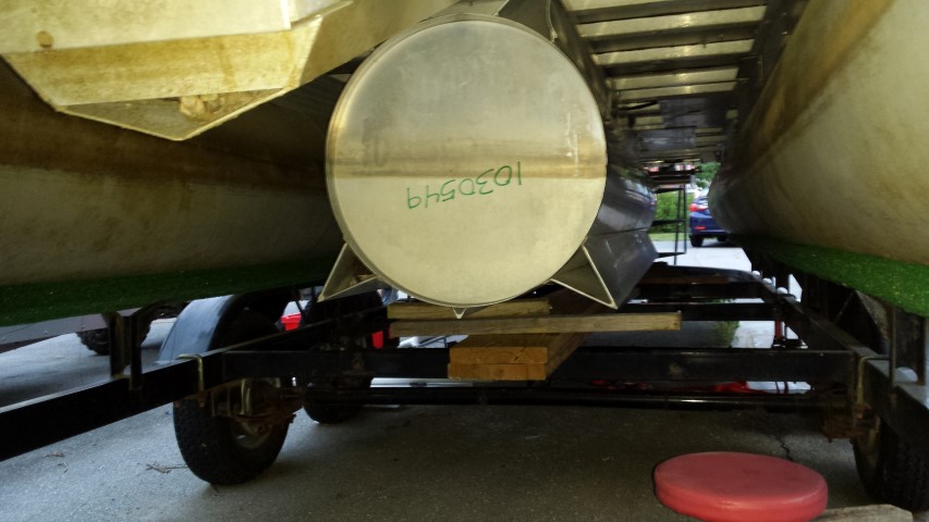

Looks real nice... Can't wait to hear results. Could you possibly post pictures of the center toon as it matches up to the transom pod and from the back? Thanks and best of luck.

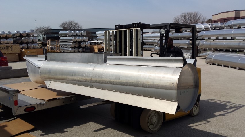

Great Lakes Skipper is where I bought my center toon. You have to watch as they are always getting new stuff in, and usually it is only a few items of each. They do have a bunch of pontoons though!
Here is a picture of the center pontoon as I was putting it into position. If you want any more pictures, let me know.
I am going to take her down to the bay this weekend!

Got her in the water!
She floats about 4" higher in the front and about 2" higher in the back.
I still have a few things to adjust, I want to change the motor height, and I might need to change the prop.
I will report back with some numbers.
