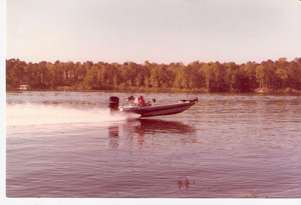

All this talk about performance issues with boats, props ,etc. got me to thinking about my favorite boat of all time. A 1979 Venture with the 115 hp Merc stacked 6 cyl engine. Completely stock setup-engine raised about one inch off the transom, 19 inch pitch 2 blade SS prop with a slight cup. For all you bassboat owners-now and before-speed was the thing. Mine was an honest 55 mph boat-quick out of the hole-no "Hydrosport crawl" and at top speed and trimmed out-almost zero chine walk-and dang near hands off steering with torque tab set correctly-a dream to drive. Handled rough chop well for a 16.5 ft boat-would outrun a Hydrosport of Skeeter Wrangler in rough water.
Dealer had one set up for speed and it would run 62 but slow getting out of the hole and kinda squirrelly, etc so I passed on that setup.
The Venture hull I had set a world record around 1982 I believe--82 mph with rated HP--would have loved to have seen that. Anyways for all you speed freaks and former or current bass tournament fishermen here's a pic taken late 79 early 1980 I believe. Toledo Bend Texas Frontier Park Marina.
