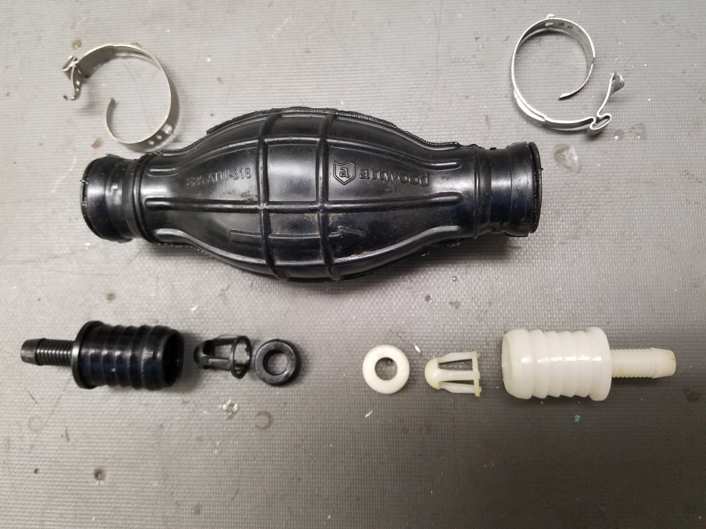

Here's what's inside my dysfunctional Attwood primer bulb.
Both valves were stuck open by a thin film of fuel varnish.
Alcohol or acetone wouldn't remove that varnish. I had to take it all apart & scrape it off with the stick of a wooden Q-tip or my fingernail.
All plastic parts appear to be nylon or polypropylene. Not hurt by the solvents I tried.
Once spotless and reassembled it worked properly.

You have a lot more patience than I do!! I would have never even thought about doing that with a $20 part!

I've ordered an OEM replacement (BRP) hose assembly and I'm waiting to get it. Best price I could find online was $62. That's enough motivation for me to take the failed one apart to see why it quit.
I'm tempted to take apart the name-brand bulb to see if it's REALLY any better made to justify the high price tag.
