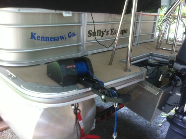

I installed the Trac 35 today. I was going to set it up on the front and looked under the decking to see maybe doing an underside mounting ? Well two things changed my mind. First I have under skin and didn't want to do battle with that, second, the wiring supplied wasn't long enough to reach the rear of the pontoon to the batteries. I didn't want to splice more wire and make it water proof, so on and so on. So, I just made a simple install on the rear deck. Only needed about 3' of wire to reach the battery, and it's basically out of the way. I will only be using the anchor in cove areas so really don't need too much, just enough to hold the toon still while we chill. That remote control is cool, I'm going to enjoy that the most.
Trac 35.jpg (111.19 KiB) Viewed 6849 times
