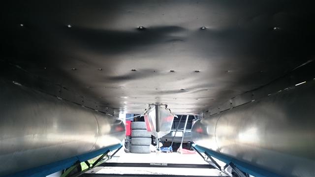

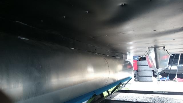

Undesskinning with HDPE
DSC_0092 (Small).JPG (39.52 KiB) Viewed 3088 times
DSC_0093 (Small).JPG (39.63 KiB) Viewed 3087 times

#41 Post by justrfb » Fri Jul 03, 2015 7:10 am
Hello All.
Thanks for the replies... Guardian, nice work! What did you use for fasteners? Is that the stuff T Cro is talking about using or is it the thinner stuff mzodarg is talking about... Please give more info, thanks! Ride, durability, sound deadening... This is very exciting! If I can keep upgrading "Da Boat", we won't have to keep thinking about upgrading with a new one...

Guardian
Posts: 2
Joined: Mon Sep 16, 2013 12:19 pm
Re: Underskinning material??
#42 Post by Guardian » Fri Jul 03, 2015 7:47 am
This is a product used to seal the landfill site
http://www.ztg-inc.com/distribution
Sorry i dont speak very well in english, i use google translator
