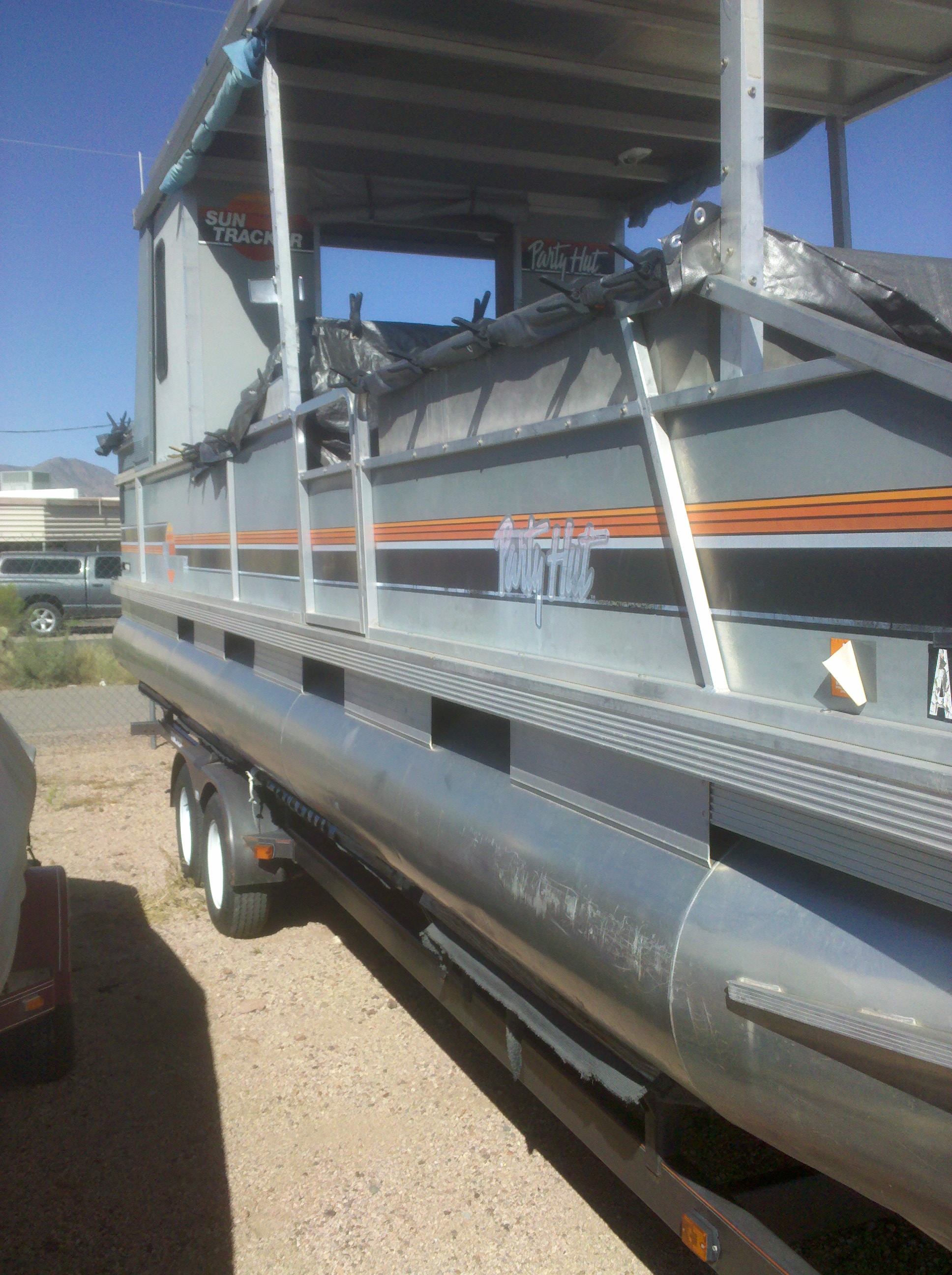

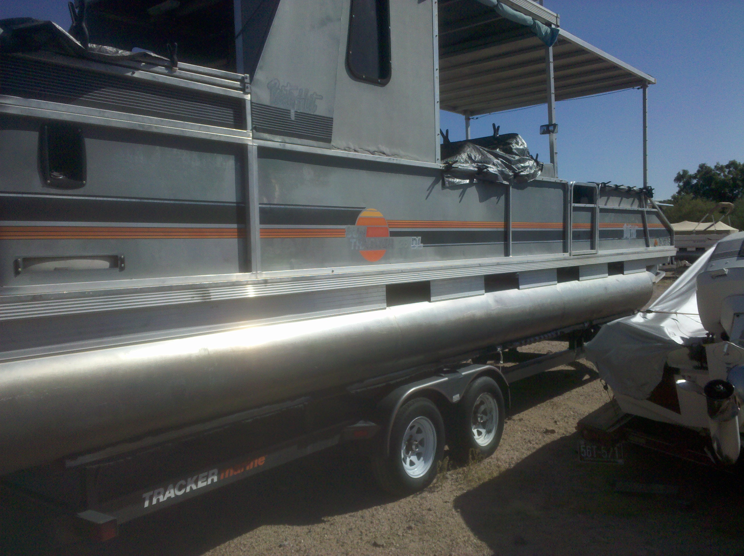

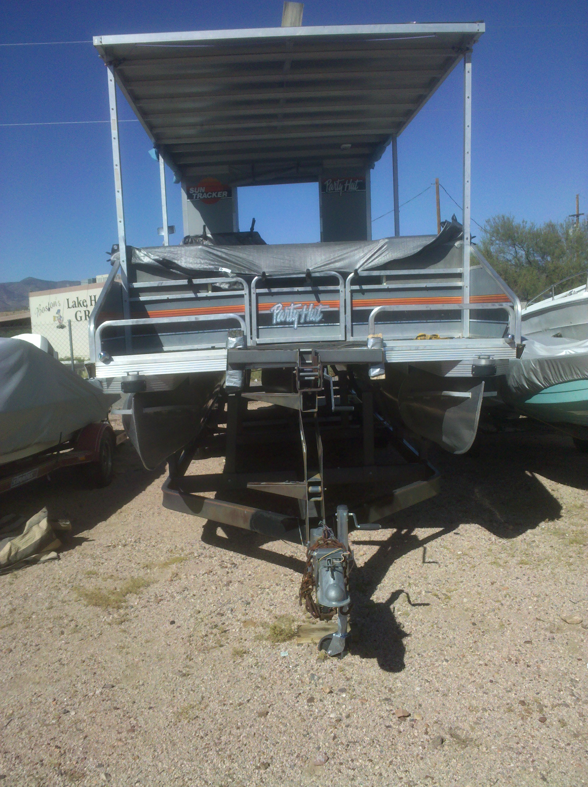

Uh Oh - the deal is ON. I will soon have a one owner 1988 28 foot tritoon Party Hut complete with trailer and running 90 hp Yamaha with blown reverse gear for next to nuttin.
Time to start tearing it down to the frame to shed excess weight. This is gonna' be a project, but I'm already anticipating the stares I'll be getting in my "creation". I think I'll call it "Puttin' on the Ritz". :lol3

The boat, especially the toons, look to be in great shape for 'next to nuthin'.
Have fun and take pics during teardown and build.

Parasympathetic wrote:The boat, especially the toons, look to be in great shape for 'next to nuthin'.
Yep, they're in excellent shape except the middle has a couple of small dents in it on the bottom where it no doubt encountered a rock - I did talk to a mechanic at the marina where it's stored and he said they're nothing to get excited about - kind of like door dings on a car. I'm a looong way off from any final cosmetic touches but I can't wait to polish them. I'm sure I'll do a small section as soon as I get it just for fun. The ultimate goal is make it look OEM. :wink:
Pictures and a "builder's log" will be done to document it for the Coast Guard approval. Once again since I'm not really modifying the boat and keeping it stock below the deck so I don't anticipate any issues.

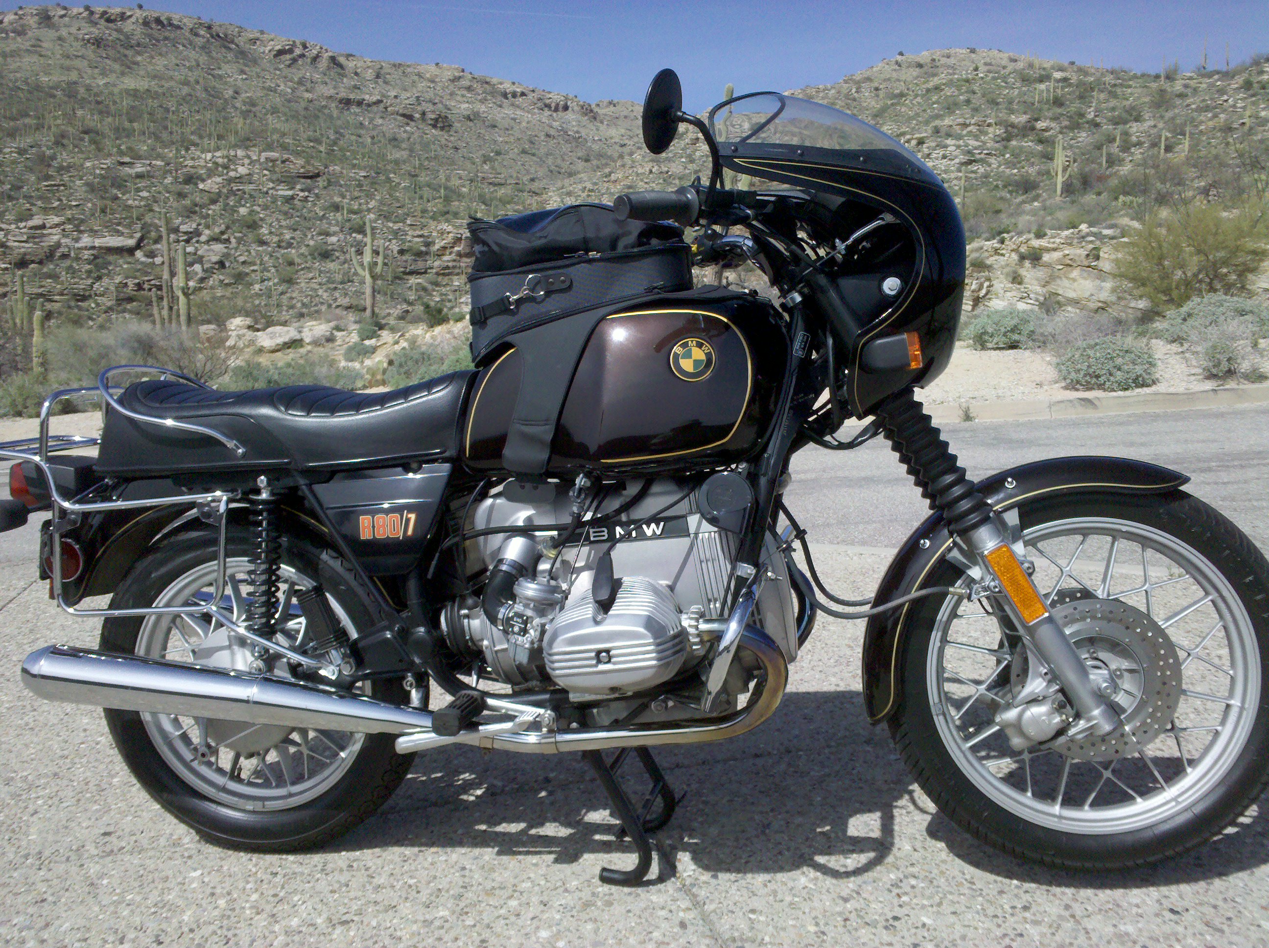

Oh well, my last one turned out pretty good: It's a 1979. (WARNING - WAY OFF TOPIC)

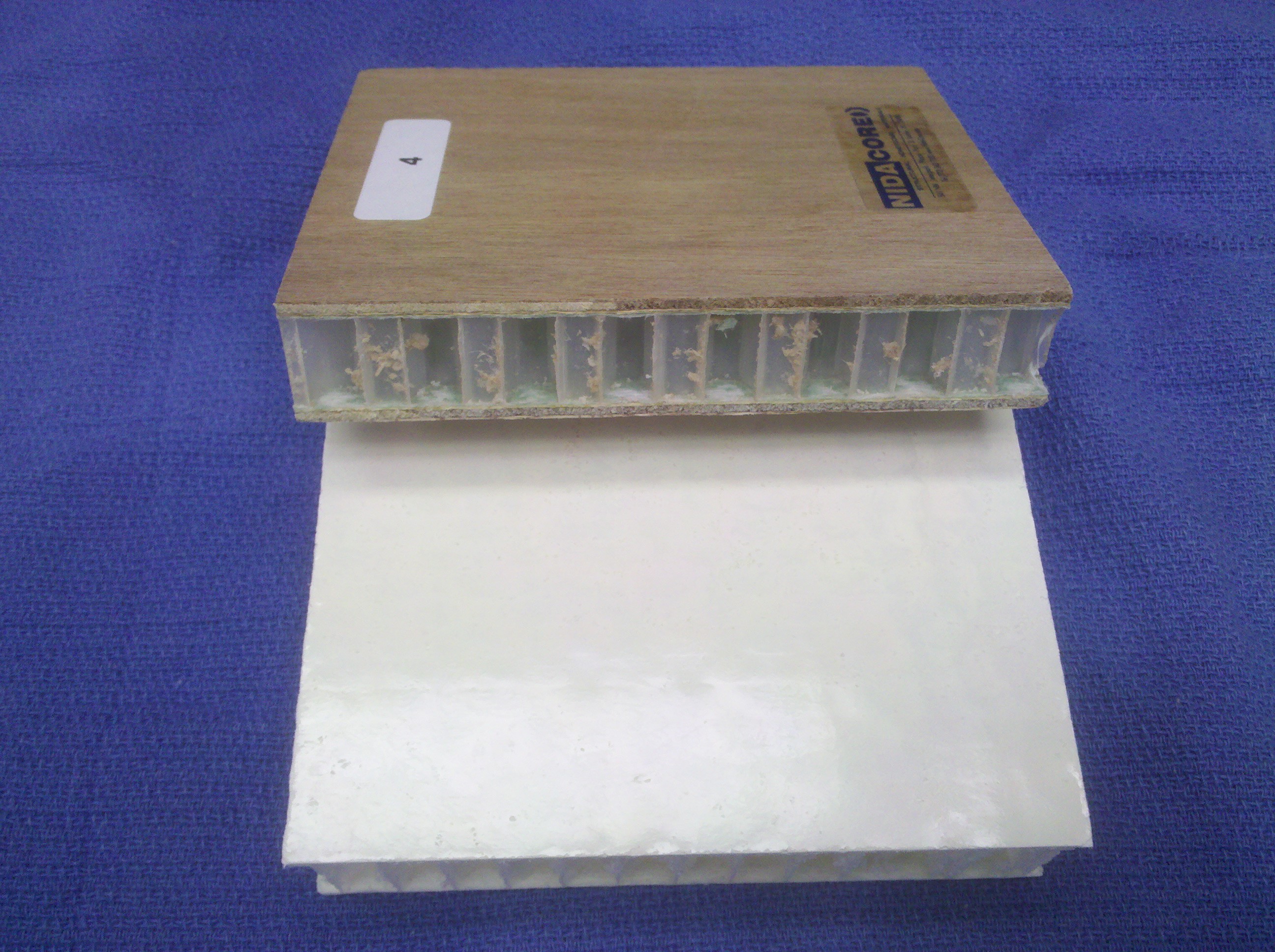

I've actually started the project and got my sample of 3/4" honeycomb :shock: deck material today. The top will be coated with a UV resistant non slip coating and the bottom with FRP. It's designed for marine use. :coffee
Much, much stronger than aluminum decking or plywood, and at 168 lbs. for 225 sq. ft. it beats the heck out of Marine plywood at 525 lbs. It is, of course 3X as expensive but at $1500.00 vs. $500.00 for plywood well worth it.
