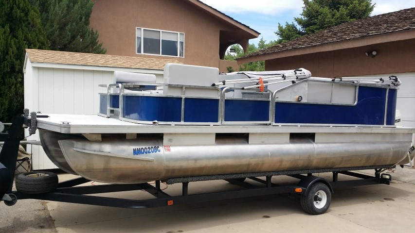

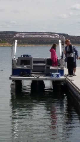

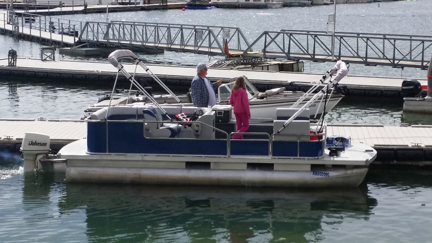

It has been a while. Time sure does fly by, especially when your in a mad scramble to get on the water. I am going to skip a bunch (mainly because I forgot to take pictures in my rush). I finally got the enough of the old girl together to put her on the water!

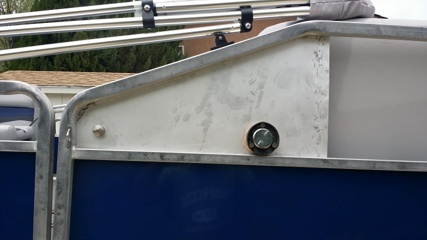

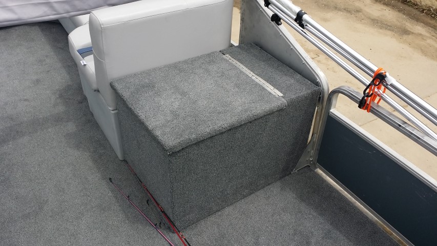

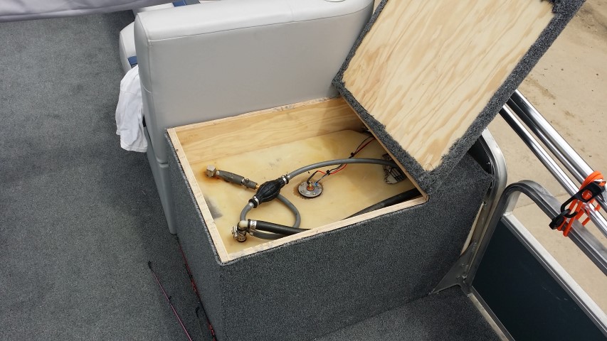

"salvaged" 18 gal fuel tank worked out pretty good. Used the leftover marine plywood to build a simple box, covered it with some carpet.
attached a piece of aluminum to the railing and mounted the fuel inlet and vent to it.

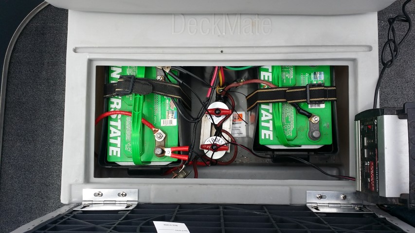

I put both batteries in one of the front seats, opposite side of boat as fuel tank.
