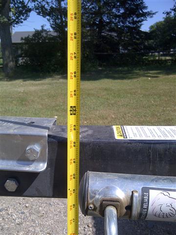

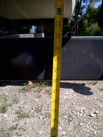

FWIW, the top of my trailer frame with 13" tires on it is at 22"... just for comparision..

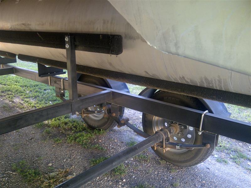

This project for me hit a wall, my axles don't have the flanges welded on to them to add brake brackets.
So I suppose I still have 2 options.
1. Replace the axle with one of similar construction but WITH the brackets welded on by the factory
2. Weld on appropriate brackets..
The second option really isn't out of the question, I would bribe my neighbor (builds circle track stock car chassis) to build and weld into place a couple chunks of steel, it would be a trivial project for him. I am an UNSKILLED welder and would leave that to the professionals.. but it could be done.
In this second picture you can see the 'cradle' that is movable on my trailer to move the axles forward or back.. Just loosen/remove 2 ubolts on each side and move it to the desired location..
The movable axle cradle does leave me with another issue.. What if I put on brakes and then later want to move the axle again? How do I cleanly route he wiring or hydraulic lines?

Ray Jr.
Posts: 687
Joined: Sun Jul 19, 2009 2:54 pm
Location: Warren NH
Re: Has anybody ever added disc brakes to a NON-brake axle?
#10 Post by Ray Jr. » Wed Aug 01, 2012 9:20 am
A top quality replacement axle with the brake flange is fairly reasonable, I had to replace an axle on my atv/snomo trailer 3 years back, i couldn't find the right spring spacing/ hub width from northern or tractor supply. I went to the Dexter axle web site and found a semi-local distributor, called him up gave him the measurements of the old one and $90 and 2 weeks later I had the new axle with brake brackets in my hand.
As far as the break lines go use a fairly long flex hose and you should have all the adjustment you need.

#12 Post by Bamaman » Wed Aug 01, 2012 6:03 pm
Disc brakes can be easily added either by buying a couple of $100 axles or by having new spindles welded on the end of your axles ($24.95 each.) Discs can be added for $139 per axle--per Championtrailers.com
