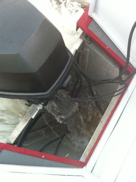

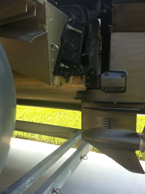

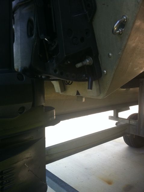

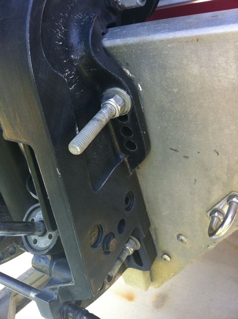

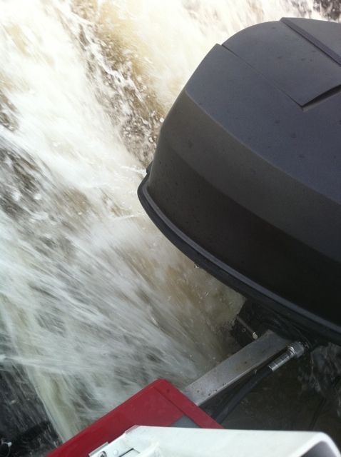

By the pics your motor height looks OK, could go a little higher but not by much, what is your prop pitch and what is your HP and boat length/weight..

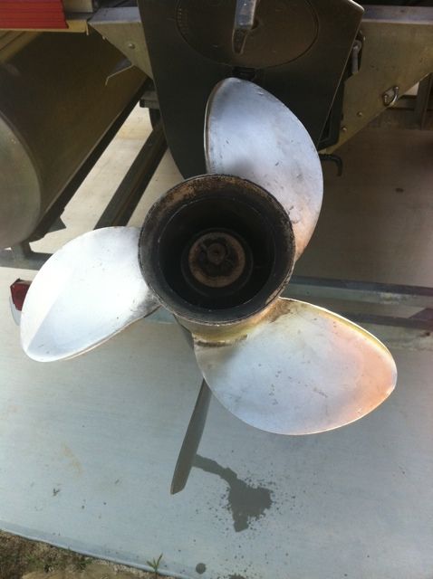

Start with a new prop 1st, find your pitch/size by some prop experts on here and replace that prop and go from there, adjust height after your new prop, also balance your load on boat, you say its front heavy than store your gear in the back of boat and/or carry more fuel in back.

Ditto on above, I think you can move motor up another notch.

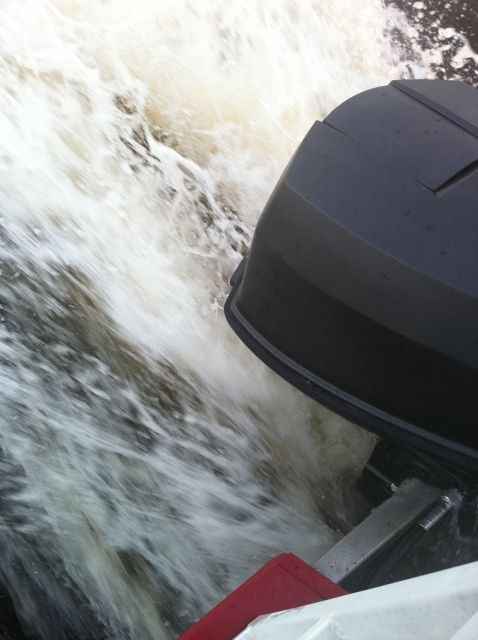

The motor is all the way down on the transom. The picture from the back side looks like your motor is pretty low.
When it's running at a cruising speed, you should be able to see the anticavitation plate clearly. I just see a bunch of splashing in the pictures.
You might want to move the engine up a notch and see how it performs. I assume that you've got working power trim.
Until you get the engine at the correct height, experimenting with a propeller is a moot effort.

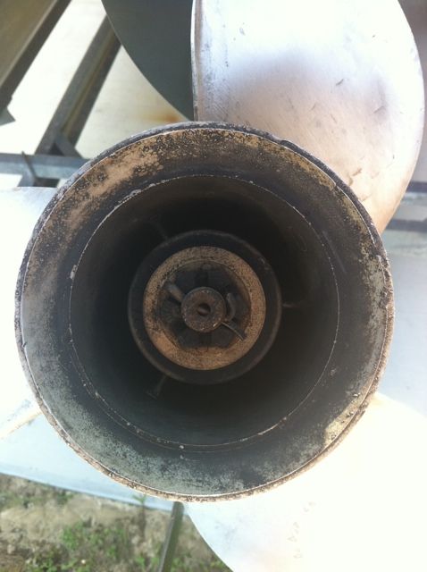

I remember that generation of OMC's to be pretty torquey motors, and 112 hp is plenty to get you up to speed. I don't know what the gear ratio is, but I would think a 13 or 15 pitch prop might work.
Find yourself a good prop shop and get them to tell you the prop's pitch. They can also give good advice. If you remove the prop, you might find a part # with the pitch as the last 2 digits.
