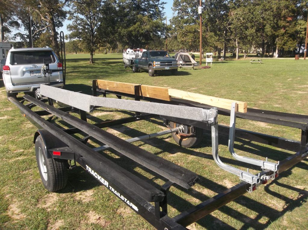

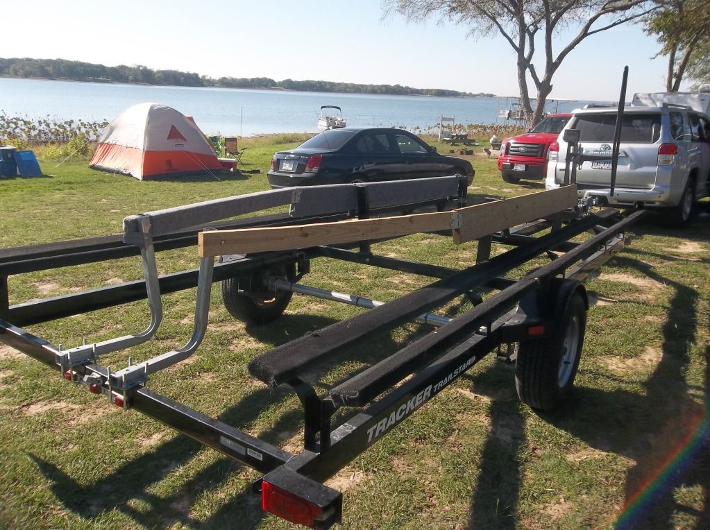

When I bought my toon it had roller guides instead of guide boards, it did have a set of guide post at the rear but i had a TERRIBLE time loading unless there was ZERO wind, and to be truthful even then it was crapshoot. I bet I'm not the only one who dreaded loading up most of the time. I replaced the roller guides with 2x8's and it made it MUCH better but I still had a tough time in the winds.
What I did was take the PVC off the guide post and moved them the rear as you will see in the pics, then I put 2x4's angled to the post and attached them.
I hadn't covered the last board before I took these pics but you will see what I am trying to show you hopefully.
This has made a TON of difference loading the boat now, I really can't stress enough how easy this made it. I load in one try now, even in high wind! I would imagine it would help if you load in a river with current also.
If you approach the trailer from either side and the toon starts turning, which it seemed to always do, give it a bit of power and the boards guide it up perfectly.
I never dread loading now and hope it helps someone else here now.

Love the duct tape! seriously though, I did the same but just ran them straight, and started pretty far back. Works like a charm, even my kids can drive it right on no problem.

spurhunter wrote:Love the duct tape! seriously though, I did the same but just ran them straight, and started pretty far back. Works like a charm, even my kids can drive it right on no problem.
LOL!
I figured I would catch some razz about that but I haven't gotten any new pics since I finished and had some time to post so I thought what the heck.
I just hoped it may help someone that may be struggling with loading up now.

Finally, someone has found some ingenuity. That's a great idea, and it even works.

Bamaman wrote:Finally, someone has found some ingenuity. That's a great idea, and it even works.
Thanks Bamaman, I have the end closed now with a shorter 2x4 just in case I happen to hit that small opening, just thought I would post up pics that I had.

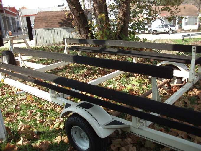

Steve... nice work on the trailer... in response to you talking about hating to load your boat... I was the exact same way last year... loved taking the boat out, but even as I was unloading, I was already worried about 4 hours from then when we had to load up...it got so bad about mid way thru the boating season that I actually thought about selling the toon.... but then I discovered these 48" pvc trailer guides... this past season I have only had one time that I didn't load on the first try, and that was because some guy came flying thru the no wake zone at about 30 mph and his wake got me off line just as I approached the trailer.... when I load now I just line up the right side of my boat with the pvc trailer guide and so far so good...

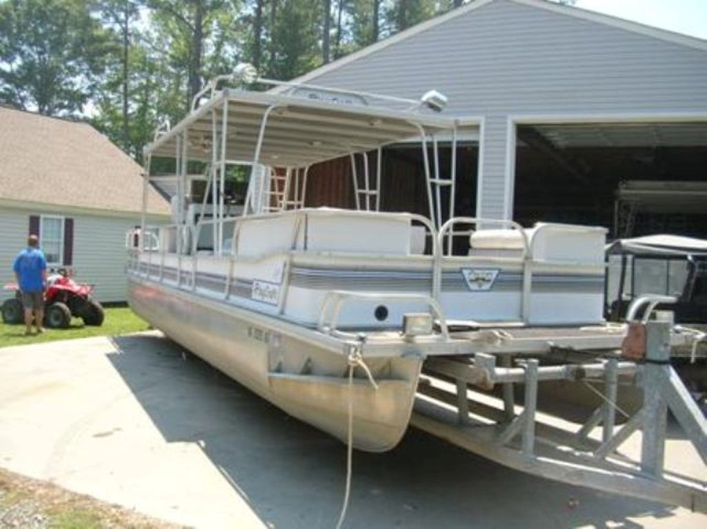

#11 Post by playcat » Thu Nov 01, 2012 9:10 am
That is one of the few good things about my scissors trailer; the supports go under the deck and lining up the toon could not be easier. I just get it kind of close, and drive it on gently...
