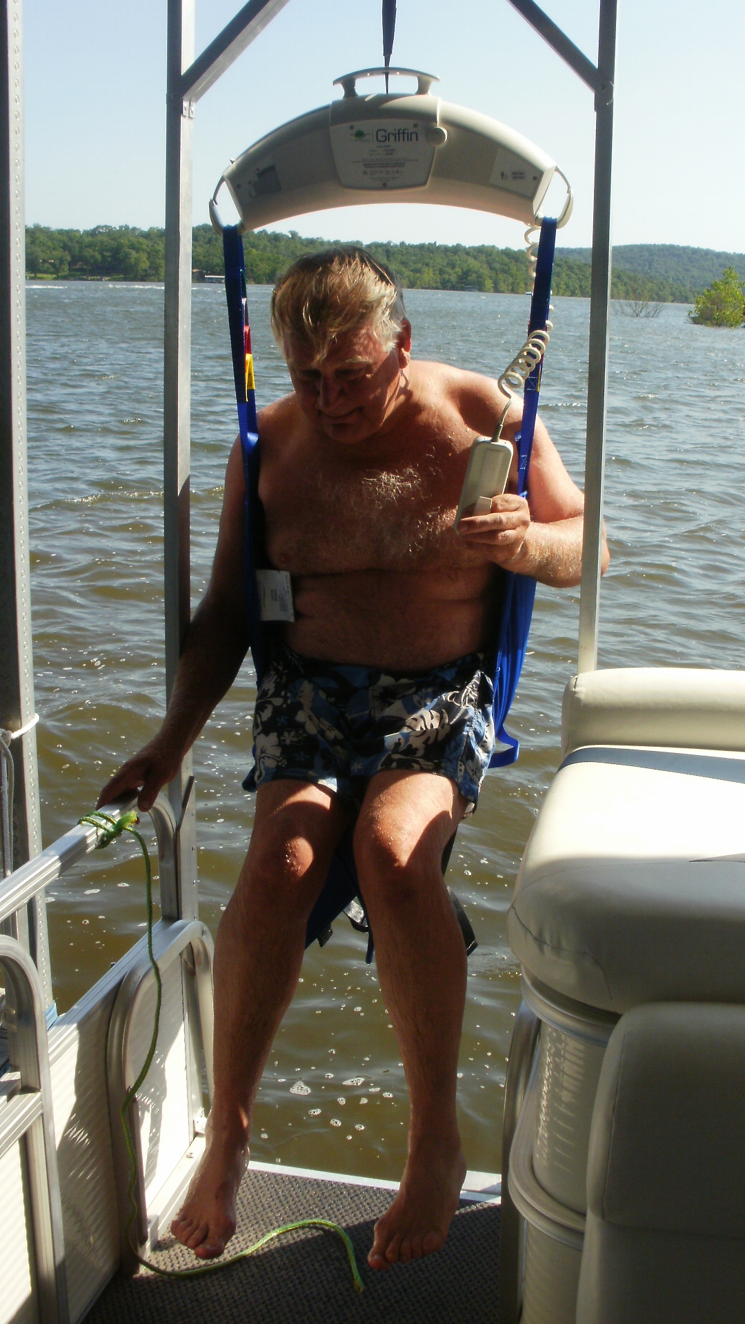

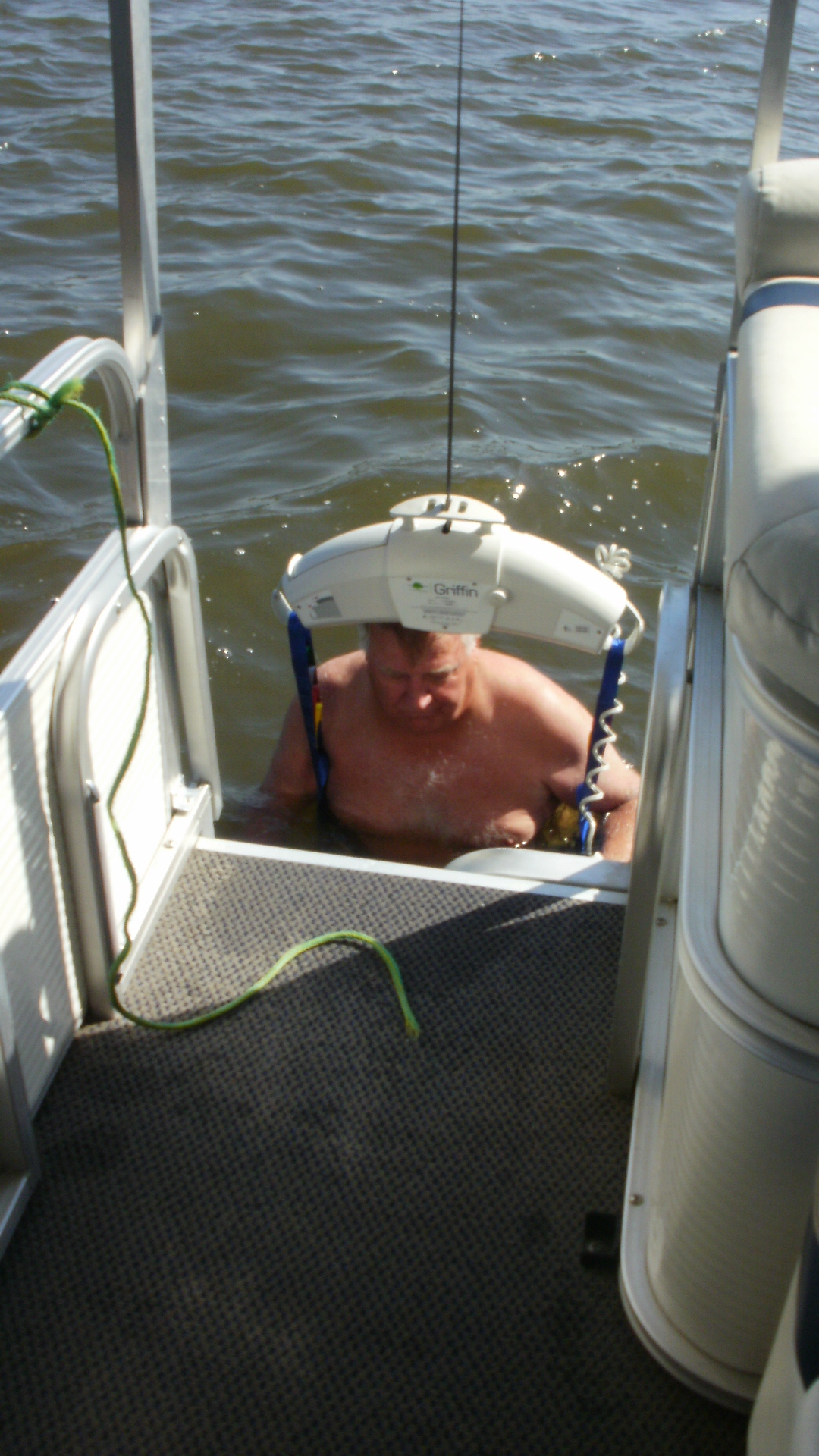

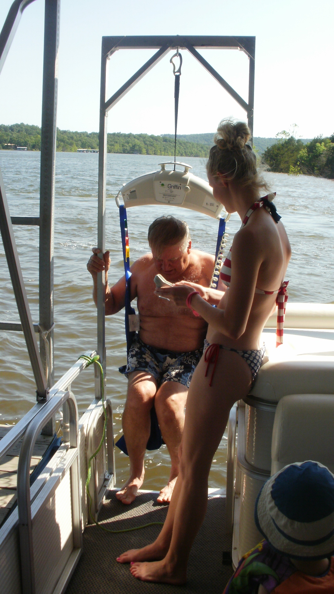

I can't see any know ramp to me at least working for your needs or situation. In most cases a ramp long enough to reach bottom would haft to be either extremely long in length or very steep and therefor unsafe. Then there is the twist factor being that river and lake bottoms are rarely flat in bottom contour. I saved a few photos from a thread on here sometime back of a lift a member designed that could maybe work for your needs. I'll attach the photo's below...
Lift Hoist1.JPG (897.16 KiB) Viewed 2347 times
Lift hoist2.JPG (889.99 KiB) Viewed 2346 times
lift hoist3.JPG (841.84 KiB) Viewed 2345 times
My files say I copied the 5/11/11 so the thread was probably active about that time if you want to look for it.

I liike the Griffin lift idea. I've been using a 6 ft fiber glass ladder.

Silver Eagle, that is my lift in the picture. I sent you a PM on 2-15-2013.

Thru pms Loyd expressed interest in how I built my lift. To make it easier for him to have the information in one place and to share with anyone else interested in building a similiar lift, I have opted to post information how I came about my lift.
____________________________________________________
I used all 1” x 4” aluminum; I do not remember what thickness.
I believe the aluminum totaled about $185.
I bought it at Shapiro. They are out of St Louis, but I had my delivered to the lake. Just cost a few bucks more. It was very easy to order thru them on the internet, offering the metal in various lengths and thicknesses, etc.. I believe I bought two 8' and a 4', but not sure.
[u]What I have: [/u]
The Frame- basically what you saw in the picture is what it is. 1”x 4”, riveted together. It has two angle braces on each side to keep in square and strong.
Attaching: Looking at the 1st picture, by the man’s foot we attached and angle with a bolt that rests in a hole on the pontoon’s aluminum angle. This keeps it from sliding back and forth, etc. In the second picture, just below his hand, you can see where a plate was riveted onto the frame. This overlaps onto the pontoon’s frame. We then put a pin in that runs thru the plate and then thru the pontoon’s frame. We did this on both sides.
The frame can be taken down in two minutes by pulling the pins on both sides. We usually leave it up except in winter when we seal the boat up pretty tight.
We put a SS eyebolt in the top for the lift to hook to.
I will edit post as I remember things in more detail.
