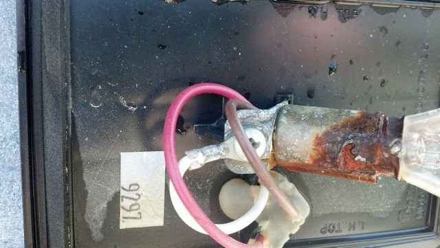

Well, saltwater isn't the best for anything. If your trailer is galvanized, you're generally ok. Most of us know, or have found out the hard way, there are NO submersible lights that are good, unless they are sealed. The components they use for the bulb sockets are usually the worse. I take my boat and trailer through the car wash after every saltwater trip. I rinse the boat good, but concentrate on the trailer mostly.
If your trailer is not galvanized, I wouldn't think about it even once. There are so many little holes and crevices for the salt to lay in that you will see rust start up soon after.
Here is a picture of my new lights after 6 trips in saltwater. The lights were new "submersible" lights......

holy hell!

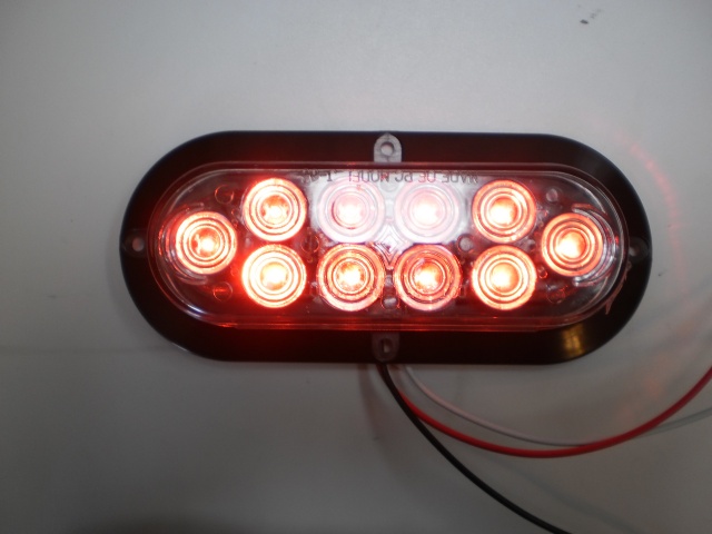

What's hard to find is "sealed" lights. They had them for my bass boat trailer. But those are mounted in cutouts on the trailer with rubber gaskets. I may try and make brackets to hold those on my trailer. But the LED thing seems like something easy to try. Maybe even seal the wire connection in epoxy.

Man that sux glad I don't have to deal with that. I've got tail lights that are 20 years old that don't look that bad.

These are the only ones I have found. I'd have to manufacture a way to mount them....
