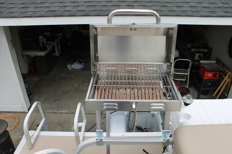

Finally! A day off and better weather. Taking the boat out for the first time this season without my wife would result in a homicide at my house so instead I tinkered.
I had been itching to get a grill mounted but just never got around to it until today.

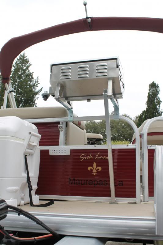

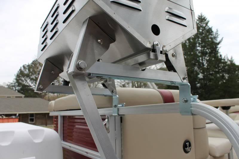

My sister got me a grill for the boat for Christmas. It didn't have a flat bottom like most do so I had to modify the feet a bit. Then I ordered Arnall's grill mounts. Pretty straight forward install, just had to notch the cross braces so I could still remove the grease trap.

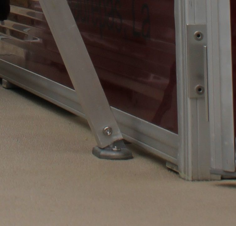

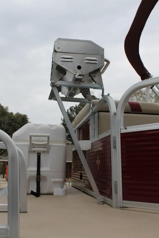

Reviews online stated that the Arnall mount was very strong and would hold most grills securely. It does indeed but my issue came from how much the fence traveled when the grill swayed. To make myself feel better I ran some support from the outside of the brace to the floor.
I recycled the old mount for my original transom saver which just so happened to have the perfect angle for the job.
The fence still has a small amount of movement but if need be I can install the brace I found on Pontoonstuff.com. Originally I wanted to mount it over the water in case of any mess. The website claimed the brace was easy to install and remove from the fencing, but that's not entirely true. So I decided to mount it over the rear platform. It's vinyl so I can clean it if something spills.

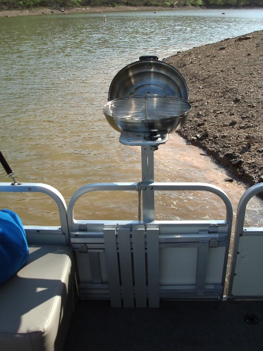

I have my grill so the drippings hit the lake,and i really like the looks of the boat buckles may have to get a set i have been using a set of ratchet straps I cut down.
my grill and a table on the rail.

MH Hawker, I originally test mounted the grill on the starboard side of the boat over the water. It was a PIA to mount it and we didn't want to leave it hanging over the side while towing the boat. I do like the table you have and how you mounted it. I may "borrow" that idea!
