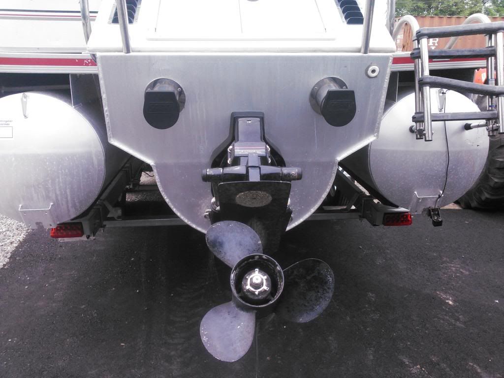

I like the idea of a inboard , nice clean back and this thread ,http://forums.iboats.com/completed-boat ... 73089.html has helped .Im going to build a new engine pod/transom either way to clear the rear deck because Im going to open the back of the pontoon up for a rear fishing deck this winter .

I havnt decided on the pods shape and size yet ,ideally ill find a cheap donor toon to take a toon off of to make a third toon with a rear pod out of which would save on sheet metal fab work.

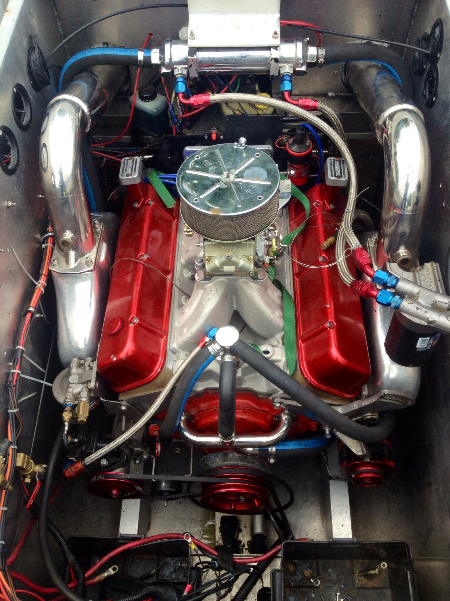

I like the idea of the 3.0 inboard. I have been through the pains of dealing with older outboards . I have blown up and rebuilt a couple. I know I saw a 20'x32" elliptical on ebay the other day. I think that would be a great base to start fabrication off of. Lot of extra flotation and width to carry the I/O set up.

Might have found a third toon to build on , I checked with a scrap yard and the said they had a pontoon with one good tube that was they think is a 24" or 26" tube . My boat has 22" tubes on it I would think a larger center tube would help handling but Im not sure on that ,what do yall think ? I would be cutting the tube down to fit under the deck but I was thinking about going pass the outside tubes about a foot in the back . Im going down to check it out this weekend if I dont have to work.

I would think a larger dia inner tube should be just fine, and should also help your handling (esp turning ability). I would want to check though and make sure the center tube isn't too much bigger than the outter ones though. I'd have to have a seesaw effect from side to side.

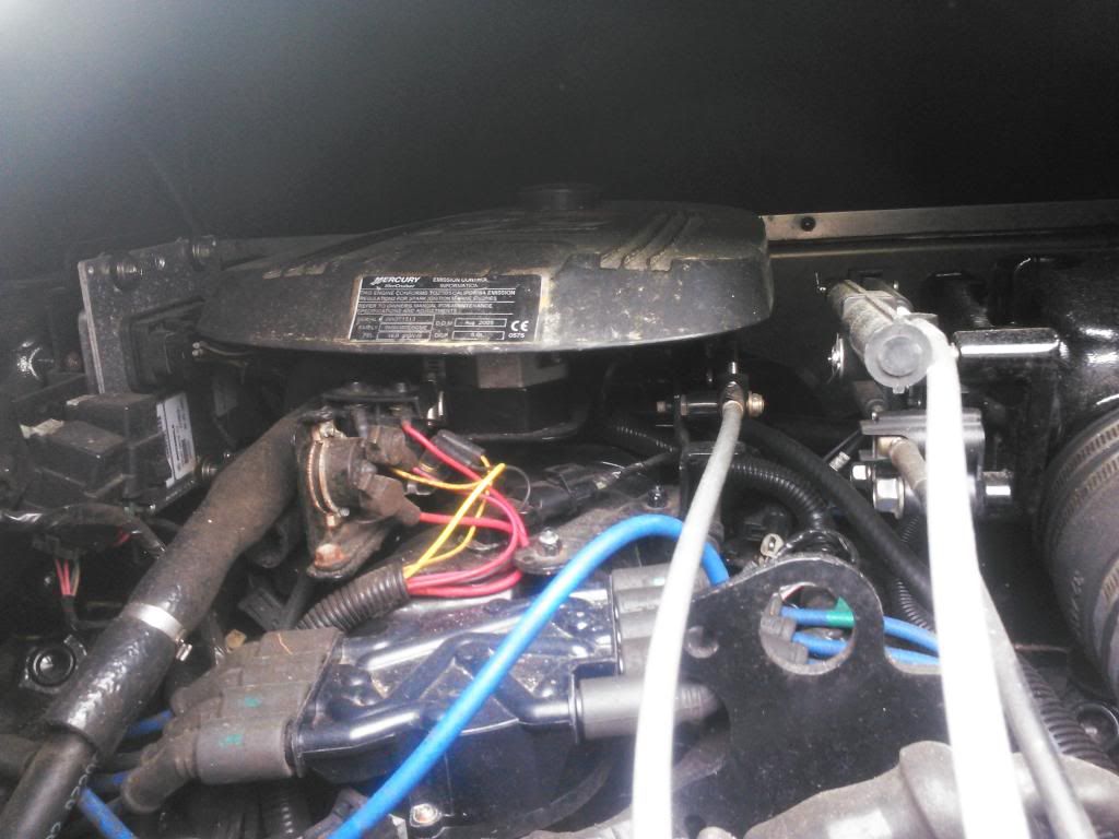

My 1993 Playcraft has a 5.0 I/O and let me tell ya...cramped is an understatement! Changing the fuel filter requires being double-jointed and arms as long as an orangutan. Spark plugs? Pay someone else to do that. New starter was $200 and $700 in labor to change out - OUCH!
My engine sits in a custom fiberglass pod shaped like a small boat and built into the entire stern of the toon. Just because the engine will fit does not mean its a good idea; JMHO.

Yeah I was joking about the 8.1 and other V8s . I will going with the 3.0 or 3.7 , most likely 3.0 , there is a 3.7 down the road for cheap though. The inline 4 should be fairly easier to work on than your v8 . I stopped by my friends house today and he told me to load up the vortec 8.1 and carry it home with me , I told him I wouldnt waste my time with it ...... but maybe a 12 valve cummins ..
I would be the only guy on the lake rolling smoke with a pontoon ..
we both had a laugh about it , them 45 minutes later at lunch he seriously asked did you read somewhere that some one has did it ?

Oil filter top right, 5 mins to change. Fuel filter on left, also 5 mins to change. JT
Re: Going Inboard...
It is most certainly doable. My filters are easy to get at as well. As I just had the motor out for mods, I did all the things down low that I could, including water pump and starter.
